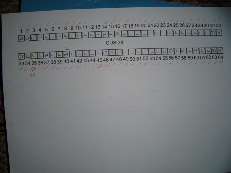

There are no schematics for the board so it complicated things greatly. I kept returning to the PCB trying to find a fault but couldn't (concentrating on logic chips mainly). However, today I decided to map CUS 38 and compare it against my worker. The pinouts are below (D - dead, L - logic, H- high, G - ground).
Pin 45 was dead and all other pins seemed to be ok. So I traced pin 45 on my worker and it went to 10C a TMM2016BP RAM chip and 9D a 74ls174. I had no continuity on the faulty board. So I tracked down the break in the trace - it went beneath the crystal clock. There was slight amount of corrosion from the crystal through hole that had spread to the trace, very close to it. I patched in a wire trace underneath the crystal over the broken trace.
And Sky Kid lives again - it's such a great game I had to repair it, even if it has been sat on the repair pile for nearly four years.
