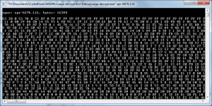

This is what I came up with: I didn't try the roms since I doubt that my approch is functioning.
I don't understand what this 2 parameters are:
decode(m_region_ptr, m_decrypted_ptr, m_decode_size, convtable, m_numbanks, m_banksize);
C:

Output:

I sort of got it!
one needs to decrypt the 116 and 109 eproms one time as data and one time as opcodes. Combine each with the unencrypted 96 eprom. Burn the opcoded in the lower part of an 27C010 and code in the upper part. One need to add an empty 27C128 file to each side so each half in equal in size. After that conect the M1 to A16 and it work. This method only works if one uses an single rom for program.
If 3 eproms are used, burn each opcodes and data the same way in an 27C256. Do this three time for the 116, 109, and 96. Connect A14 to Z80 M1.
This is not exactly what I itended to do but it's a good walkaround that works for me.
Have fun and hope you are not disapointed with this outcome.
