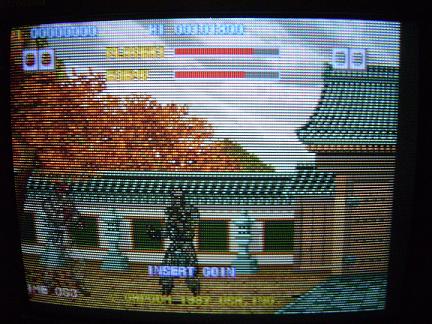

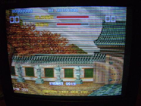

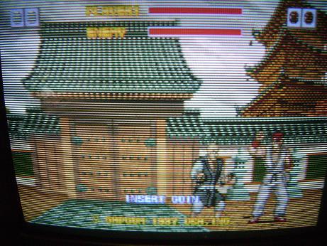

This board was partially working but missing all sprites and had horizontal lines through the picture

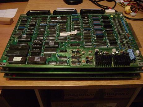

not much information about this board, 3 stack board with a serious amount of proms and roms, No manual or schematics or even repair logs that i could find.
Had the bonus of having a second boardset to work with so swapped the boards round a bit and narrowed the fault down to the middle board, The other 2 seemed fine.
Middle board very clean and no obvious damage or corrosion anywhere and no previous work done.

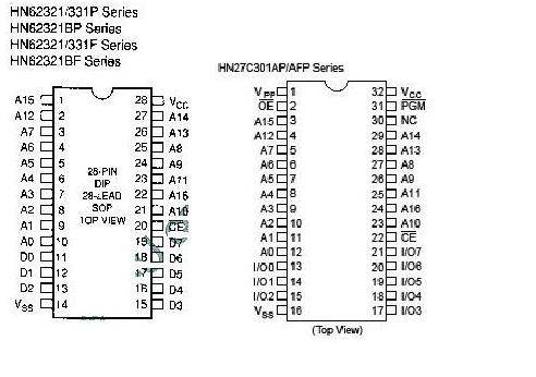

Started with the roms, (I'll explain this for anyone struggling with reading there own roms as it confused me for a while)
These are Nec 28pin mask roms so a little awkward to read. I found some information on this subject and they are the same pinout as Hitachi HN62321's and a similar pinout to 32pin Hitachi HN27C301G's. My chip reader (GQ-4X) won't read the 6321's but it will read the c301g's so i read them by patching a wire from pin14 to pin 16 of the zif socket of my burner which gives it the same pinout as the hn27c301g, The GQ-4X also prompts for a patching wire which is also required as these are non jedec.
The roms turned out to be fine and all read into romident. Went for the proms next by swapping them with my other board, these all seemed fine with no change.

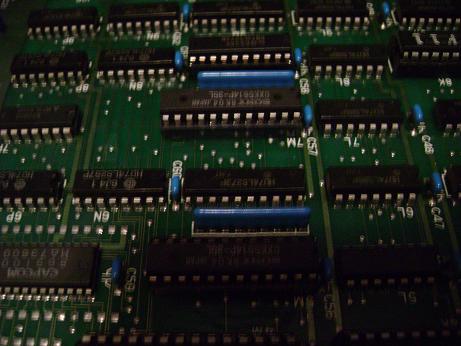

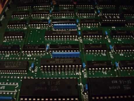

I brushed my hand over all the chips with the board powered up for a few minutes and the CXK5814P ram chip located at 5M pretty much took the skin off my fingers, It looked shiney and new so i shotgunned it briefly and this was the result

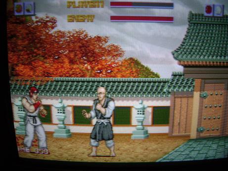

Sprites partially returned so i swapped out the ram for a new one and the sprites returned fully
The horizontal lines still remained so i poked around with the logic probe near the other ram chip at 7M this wasn't doing much just stuck low on most pins and the LS273 at 8M was the same, Shotgunning them did nothing so swapped the 273 first which made no change so pulled the other ram out and replaced with another new one and good result working 100%
Glad this wasn't to tricky as it's a big boardset with alot of proms! Love the game with its dark muffled Sfx and eerie music, Really takes me back.
