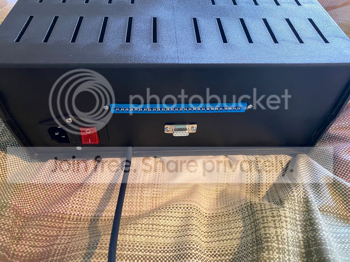

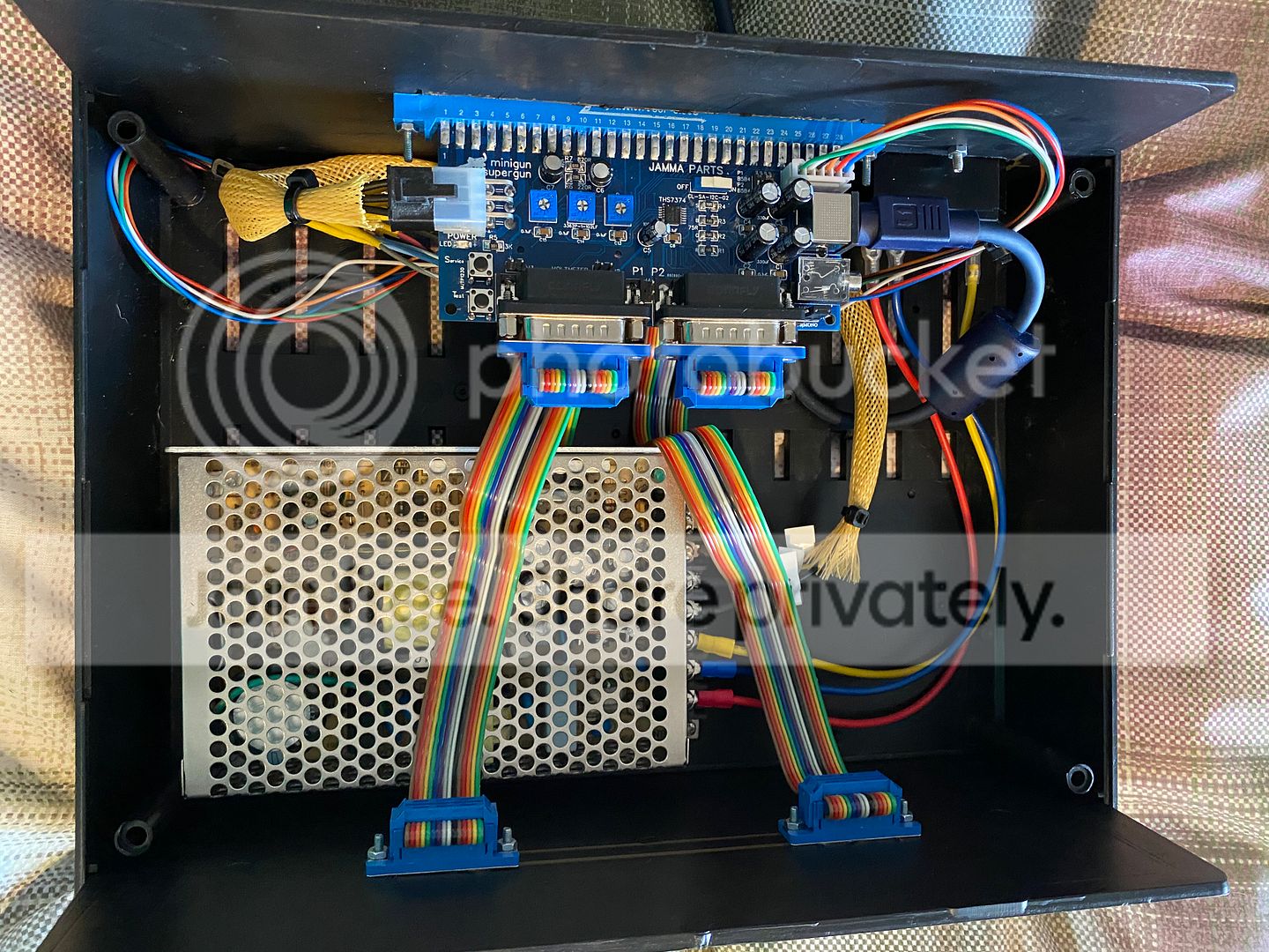

Back in June I posted a WTB for a Supergun setup. Thanks to one reply in particular I was inspired to build my own solderless supergun! It has been complete for a while now but I thought I would post this up to hopefully show that it just takes a bit of perspiration and inspiration (thanks, Titchgamer!) to produce a perfectly acceptable result:
It took a couple of weeks all told as I had to order some bits that I missed out. I had some issues with the SCART connector, every standard cable I tried didn't work, luckily I had a high quality Belkin cable which worked fine so I had to use that in the end.
It's currently set up with only 1 controller port because I have no friends. But seriously, I ran out of enthusiasm for cutting the case as I found that to be the hardest and most frustrating part of the build!
I would like to eventually build on into a metal case but that would take some real skill to fabricate so I'll stick with this for now!

Absolutely agree, I find that if you need to constantly change voltage then the PSU doesn't have enough draw at 5V so you are over-compensating by upping the voltage to increase the draw. I prefer to use a decent PC power supply for superguns that has higher amps on the 5v and self-regulates to keep the 5v at 5v. On the odd occasion that the power supply is not providing enough voltage, then I know there is a board fault/dirty connector somewhere.
90CR
The supergun PCB has a voltage meter on it. I might actually mod it so there is a readout on the front of the casing.
I ended up cutting the holes with my Black & Decker hobby tool, bit like a Dremel. It was incredibly messy and very easy to overcut the holes so I did a fair bit of cutting with a hobby knife and doing a lot of filing!

Cutting the plastic was harder than I thought it would be. The plastic heats up when trying to dremmel it, very easy to go wrong (look how wonky my jamma harness hole is
Pleased with the overall results but might look at a smaller case in future along with trying to find some sort of 8pin mini din mount (I searched everywhere with no luck)
