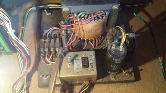

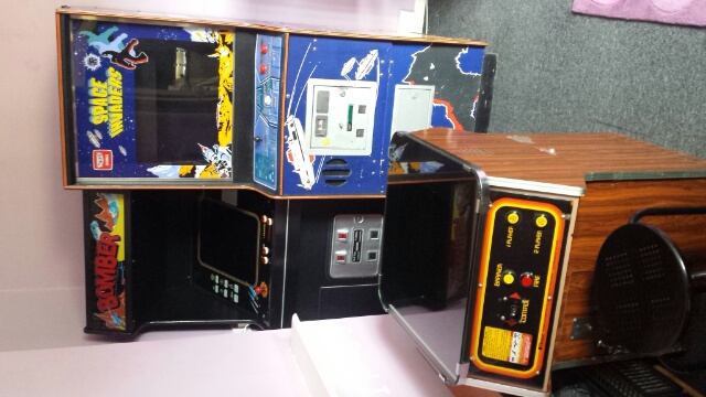

Oops! Picked this up on saturday. I won it off Ebay. The guy had it powered up, and the monitor worked but there was garbage on screen. We put it in my friends estate car, but it would only go half way in due to the increased width when it got to the control panel. So, we had to drive back 8 miles to Lichfield with it sticking out of the back of his car. There are some nasty speed bumps just as you get close to my flat, and i gritted my teeth as we slowly went over each one! When we got it in my living room, i powered it up and discovered that the monitor was now dead. I would love to get this working again, but have no technical abilities at all really. The Marquee, backdrop and coin slot lights come on, but that's it.

Usual checks for something that has been thrown around would be:
Is everything firmly plugged in to everything else? No loose cables flying around?
If you have powered it up, is there any glow from the monitor neck?
Have you checked the board for any obvious damage to chips.
If it is two boards in an L shape - are they connected firmly
After that, multimeter time sir!

Good to see some pictures after your little adventure. I won't repeat what I said I on our earlier chat and the guys on here know far more than I anyway.
Hopefully you can get playing relatively painlessly and I don't need to sell you mine now.
Can't leave this without one comment though.....
PINK WALLS AND A PINK RUG! IN A MAN CAVE!
WTF!

Above the holder missing the fuse it says 1.5 A. Will these fuses off ebay do, or do they have to be slow blow, quick blow or something else? Please excuse my ignorance!
