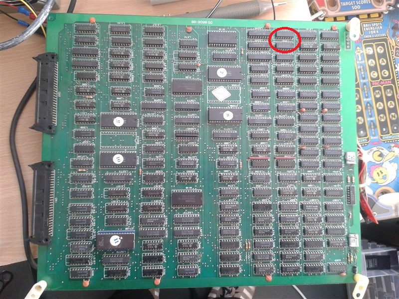

I bought a fully working Tehkan World Cup PCB off eBay, and it turned out to be faulty.
The seller refused to do anything about it, and blamed me for the fault, saying that it was fully working when it left him, only a couple of days earlier.
Anyway...I wanted to keep the PCB so went about trying to fix it.
Firstly I found that the resonator on the top board was broken. Thanks to Ben76 I found a replacement, fitted it, and this fixed an issue with the background sounds.
Next up the sprites were just lines on the screen, and I assumed that this was probably a counter issue on the lower board.
There are no schematics for this board, so I didn't have much to go on. However I found two LS161 counters that had issues by piggybacking known working chips over the top.
Sprite problem solved and fully working Tehkan World Cup!
I'll post pictures later of where the 3 items are located, as there are no location markings on the PCB

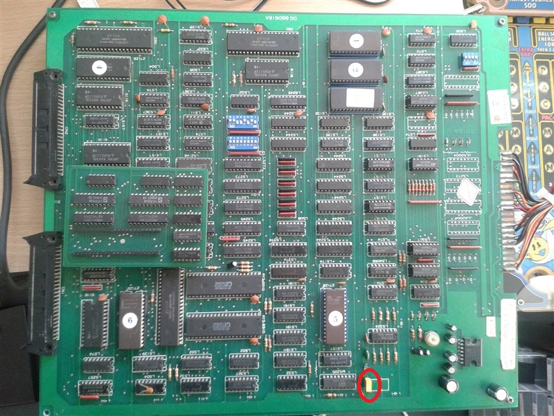

The bits I've replaced are labelled here:
Two LS161's
One CSB480E resonator. This caused issues with the background music, and sound during the player lineup:

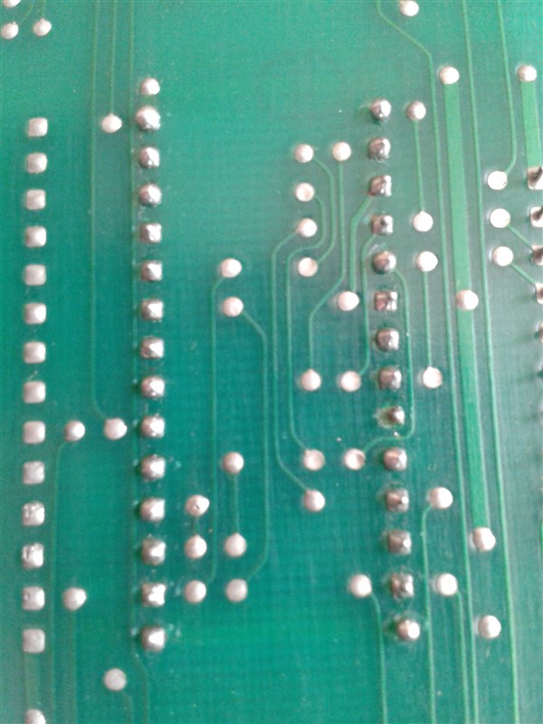

Here's someone's previous work on removing an eprom and replacing with a socket:

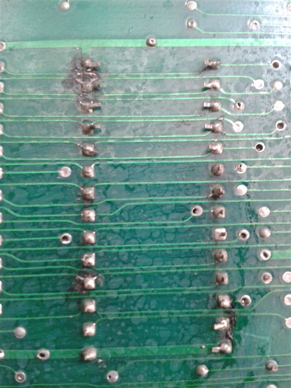

Here's my work. I took the eprom out that contained the player data to see if that was ok and it was, but the eproms were soldered to the PCB so I had to desolder and put a socket in place like above, but I think I did a better job?
Further work to be done clearly.
