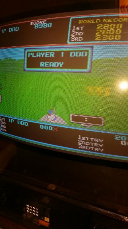

Frothmesiter's Track & Field
I forgot to take a picture of the symptom here but what was happening was that the background was just an off green colour, game would play in the background but you could only see the sprites.
Diagnostic ROM inserted and sure enough can't see anything on the screen but you hear the music play and the runner runs across the screen.
Started at the end of the circuit and worked backwards through the 157's and the 273.
Finding input to the 273 but nothing moving on the output I was poking with the scope when the graphics suddenly flickered back to life - note all signals TO the chip were present.
Reflow around chip and check traces for damage and backgrounds are restored.
Game has an intermittent halt/reset/watchdog issue still - every now and again the game will freeze and reset.
A little problematic to find this one - had to use the old "inspection eye" tool and look for problems - tapping the board brings it back to life.
Did preventative ROM pin cleaning and socket evacuation - gets better results.
Eventually I figured out by trial and error that the problem was on the sound board - reflowed a tonne of dry joints and found a small cap on the edge of the board twisted over so its legs kept touching - touch them together - game resets...... Spread them out neatly and all good again.
I booted the game and decided to have a quick go and discovered some of the speech missing - it would should "on your marks" but that was it.
A quick pull of the EPROMs on the sound board and a ROM ident via the online tool and find that C9 doesn't match anything - burned new EPROM and we have everything back to normal.
Not sure if this version of the diag rom has a speech test in or not but all sounds passed and sprites and backgrounds looked fine.
