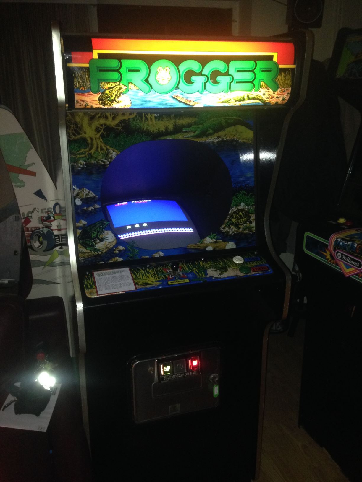

I've had this cab for a while now and not done anything with it since I got it.
The last time I switched it on it had vertical collapse and no sound, I didn't know whether any of it worked apart from the marquee & coin door lights.
After sourcing a nice burn free monitor I got round to fitting it and tried the machine out.

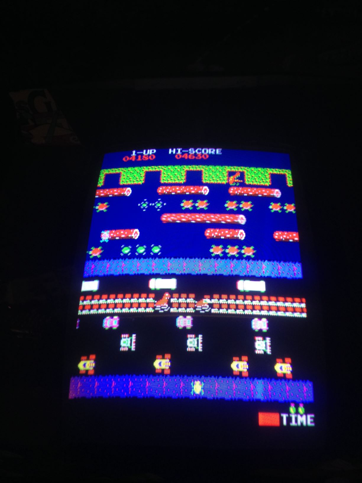

After some adjustment is was looking pretty decent...
The pictire is very wobbly and on occasion has scratchy lines appear through the image but good colours and detail.
You can see the obvious graphical glitch along the 2nd row of cars down from the top - a line of garbage and corrupted sprites. Nothing else seems affected though.
I am hoping this might be a single component but I've not even started to look at the pcb properly yet apart from reseating chips.

It's so good to see the game at least partially running and playable. I really love the style of this game and I think the Zac cab fits the theme really nicely - gotta love those green and red coin inserts
Loads more work to do but here's some shots of it how it is now:

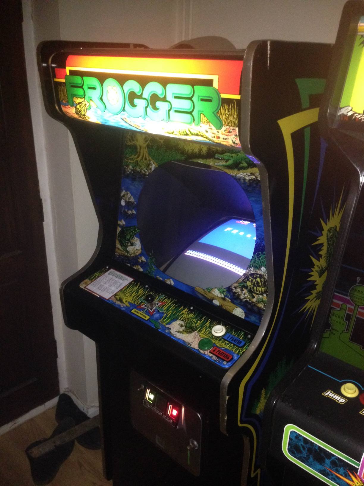

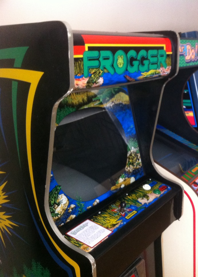

want, but I did find 2 more that give a little teaser of the artwork...
Both sides are pretty much intact apart from a gouge at the bottom of the right side and plenty of knocks and dings.
The good thing about this art is the thick clear coating on it, while there are lots of scratches most of them don't go through and appear as indentations on the surface instead.
These were taken before I fixed the inner cardboard back up that was hanging below the top of the bezel. I like the deeply mounted monitor on this game.

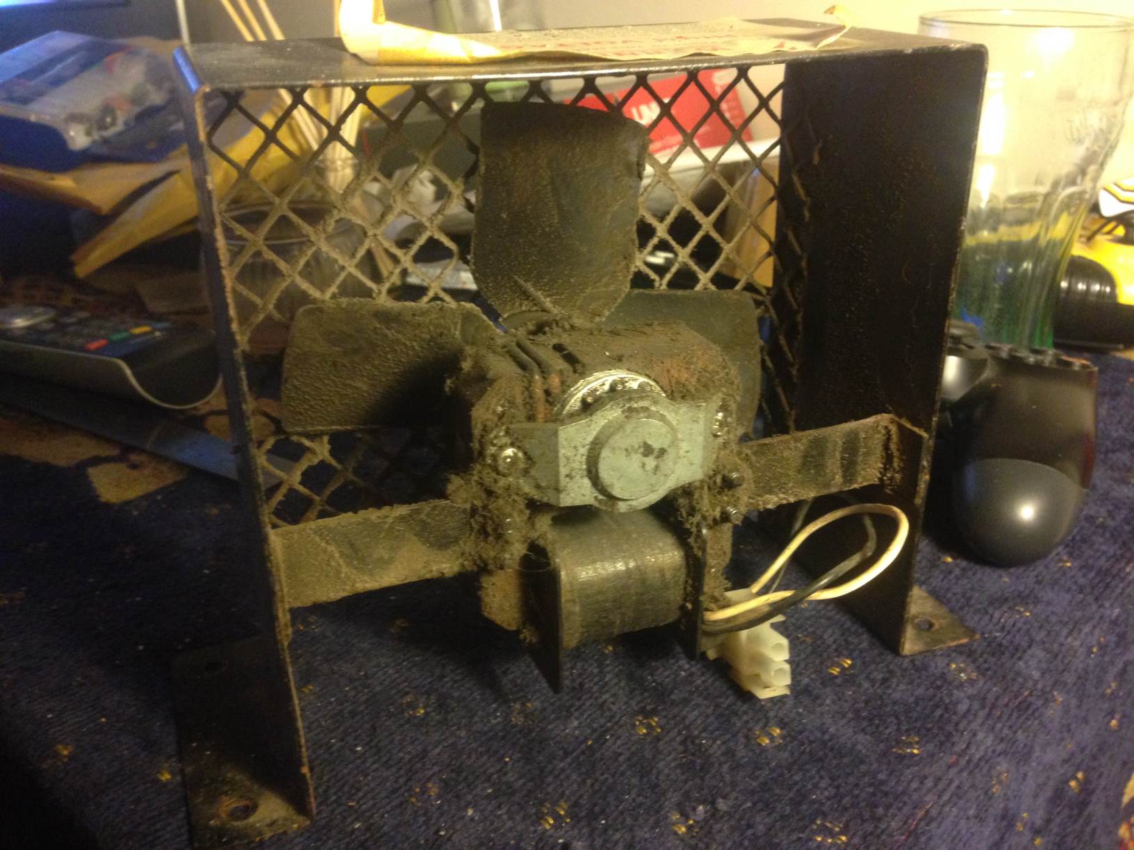

The last few times I've switched the game on the crackling/distortion seems to have got worse.
I think a thorough service of the power supply and monitor chassis is in order.
Check out the cooling fan - it looks like it could have come out of a Lancaster Bomber or something.
It needs a bit of a clean-up too

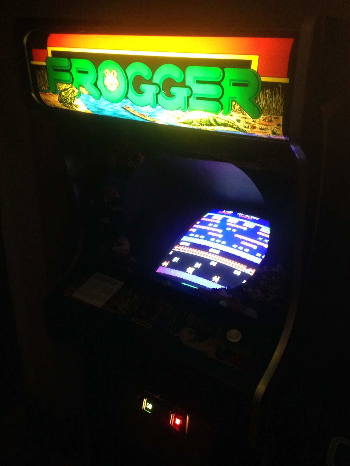

I only knew of the bog standard Sega woody.
Will do when I replace this lead which will hopefully fix the camera.
The Sega cab is cool but this one is very funky, it screams fairgrounds of the 80's to me
