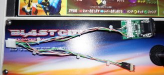

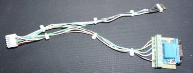

You can get away with something like the following cable which I just made as a proof of concept, but, it may introduce some dimming which can be compensated by turning up contrast/brightness. I need to get some VGA screw terminal blocks to test the cable. (The VGA terminal block connector in the picture is an Ultimarc one which is for sending signals to a monitor, I just attached that to show you what it looks like)
I'll update the thread when I've received the VGA blocks and have tested the cable on my setup.

That cable splitter looks perfect to me. What components and wires did you use (so I can source the wires and parts and find them) and what’s the wiring diagram (so I know what cables to put where to build it properly.)

The following cable is wired using the pinouts explained above. But when it's connected to CN7 on a Model 2 game, it caused my monitor to go dim when also connected to the OSSC/RT4K, and the colours were over saturated when connected to my OSSC/RT4K.
Although the above cable can get the job done, it's not the best solution if you want accurate colours with good image quality. Splitting the cable this way introduces undesirable degradation to the video signal which means you will potentially have to adjust Gamma/Contrast/Brightness levels on your monitor and/or in your video capture software.

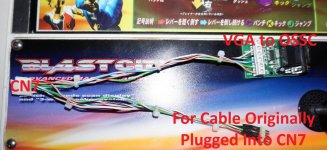

Hi all, just a heads up that I was able to splice together a cable and it works great. Have it going to a buffer board and video works great with the OSSC. I haven’t done the audio cable patch through yet but that is next. Thanks again!

The pinouts on the diagram are very clear, but I was not sure if RGB sync (Pin 4 on the JSN-NH side) would go into 13 or 14 on the VGA terminal block, since I don’t know if “RGB sync” in this case would be Horizontal or Vertical sync as far as I could tell.
I could easily see the RGB and the H V ground on the 8 pin one from Vamino’s picture, so from there I could see exactly where he put the cables in the 8 making it easy to follow it visually.
My thoughts were:
1. I was going to disconnect the original JST cable from CN7 that goes to the monitor.
2) Take one of my newly made 5 pin JSN-VGA terminal cables and run it directly from CN7 into my Extron 160 so the PCB can send the video signal to it
3) Take a VGA Y-cable and connect it to the video output of the Extron, with the first prong of the VGA Y-split going to the OSSC. The second prong would go to the VGA end of my second newly made JSN-VGA terminal cable, feeding the JSN end fed back into the monitor.
There’s a power bar behind the machine so the idea (in theory) is that, when it is turned on, the arcade unit and the Extron machine turn on simultaneously (the Extron is dedicated to the VF2 unit) so that hopefully the Extron’s signal will immediately (or close to immediately) send the video signal to the CRT.
The other thing I thought might work to save time would be to use a 5 pin joystick harness, which would save crimping time by just stripping one end and running the wires to their designated pin out on the VGA terminal. However, I don’t know what kind of wire is being used with the harness below. Bizarrely, I can find very little in terms of NH connectors. Every other type (XH, etc.) I can easily find tons of connectors, crimps etc, wire gauges, etc.
Something like this: https://www.canadianjoysticks.com/joystick-5-pin-to-5-pin-harness/
Let me know if any of that looks incorrect, a bit stupid or not advisable for whatever reason. It’s the first real meddling I’ve done with the machine so despite having opened up many cameras and computers and video equipment the nerves are still there a bit haha.

Your question is answered in section 2 of the above guide, RGB sync should be pin 13. But you can also confirm what pin it is by using a multimeter continuity test on your block and double checking for yourself.
Not sure why you would cut the original cable, but I guess you could. Personally I'd source the male and female connector and make a bespoke loom rather than hack the og cabling.
