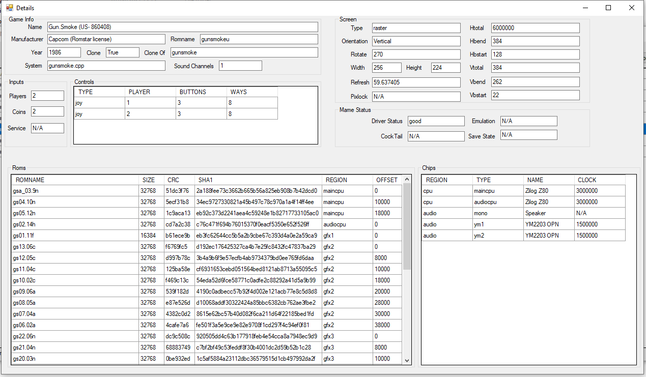

I am having an issue with Gunsmoke US Set 2 using Arcade Rom Patcher v11. The inversion works, but when it gets to gameplay, the game resets. I have verified that it has US Set 2 roms, but trying US Set 1 and US Set 2, I get the same result. Using the original or programming a new 9n with out the patch appears to work fine.
Any suggestions?
UPDATE: Nevermind :p I tried gunsmokeu and it worked. I apparently don't know how to tell what romset I have, haha. I was pulling roms and checking romident, but brute force did it. Thanks!

I used the autodetect but it would set it to gunsmokeub, which is how it was identified. I am not sure if my board has a mix of roms, but only gunsmokeu worked without crashing when game play began in attract or when coining up.

It was detected correctly as it was gunsmokeub, but it caused my game to reset when gameplay started. I tried all the US ones and gunsmokeu worked :)
I think I figured out what I did wrong :X I didn't use the autodetect on my actually 9n rom, I checked against romident and it pulled the wrong one, then I downloaded that versions and tried it.
I should just use my actual rom to save myself from trouble :)

If you check out the image I posted, I think it shows my mistake as romident pulls gunsmokeua instead of gunsmokeu with that CRC :)
Checking arcaderestoration.com, I think Hamster's website is out of date with romsets:
mgkastra2021-08-04 17:06:29
