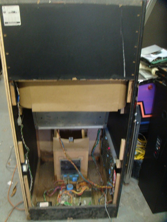

Back door was missing but have sourced a door which I made fit with a trim and looks good.
Cab is not too bad, damage to right and front bottom and some damp swelling to those areas, will reveal more as major work has started already to the sides!

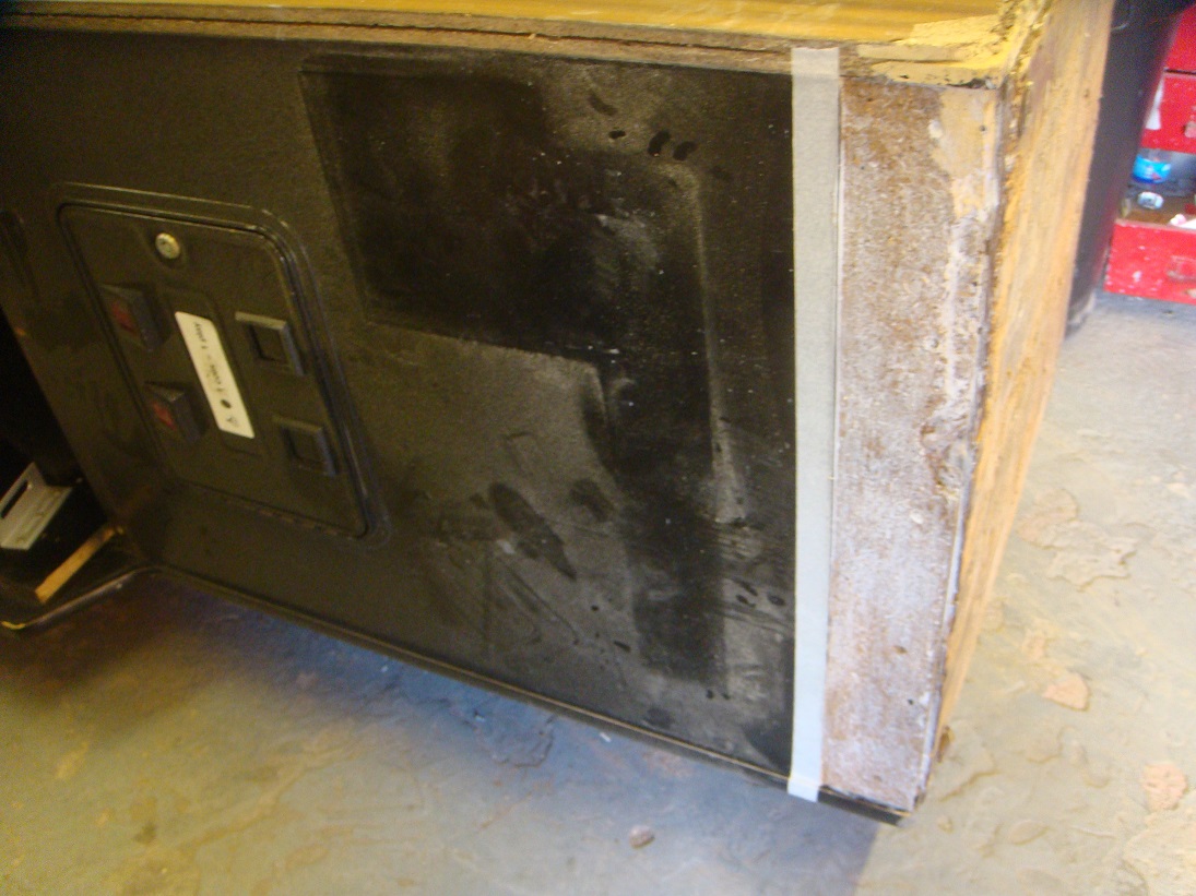

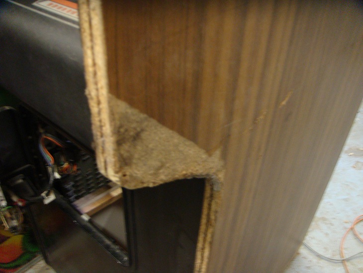

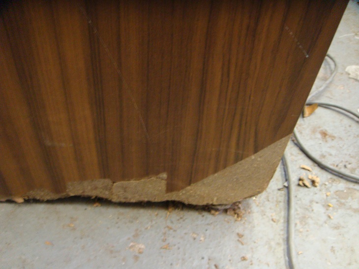

I started the cosmetic work properly on Monday at the worst bits the right side and front. Most of this was caused by it being dragged about (not by me) with the leg levelers being screwed right up, they too were rusted solid and have been removed, new one's ordered.
Ronnie Dent
1,195CR

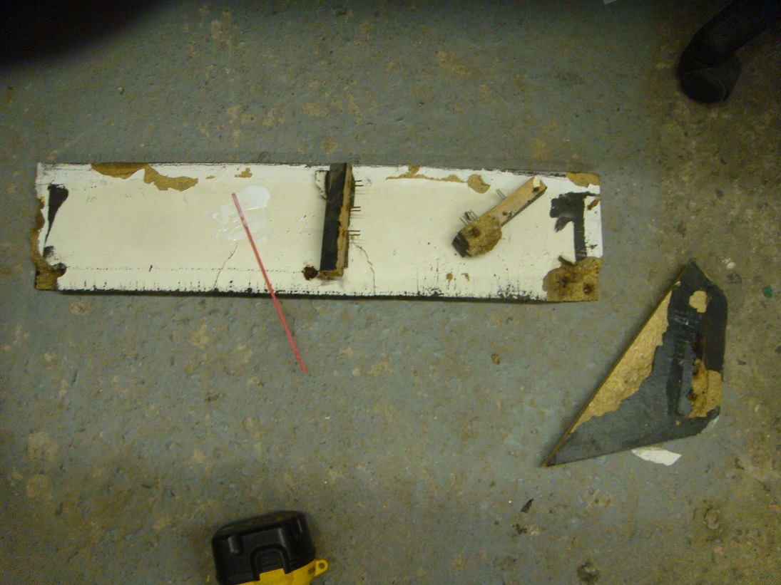

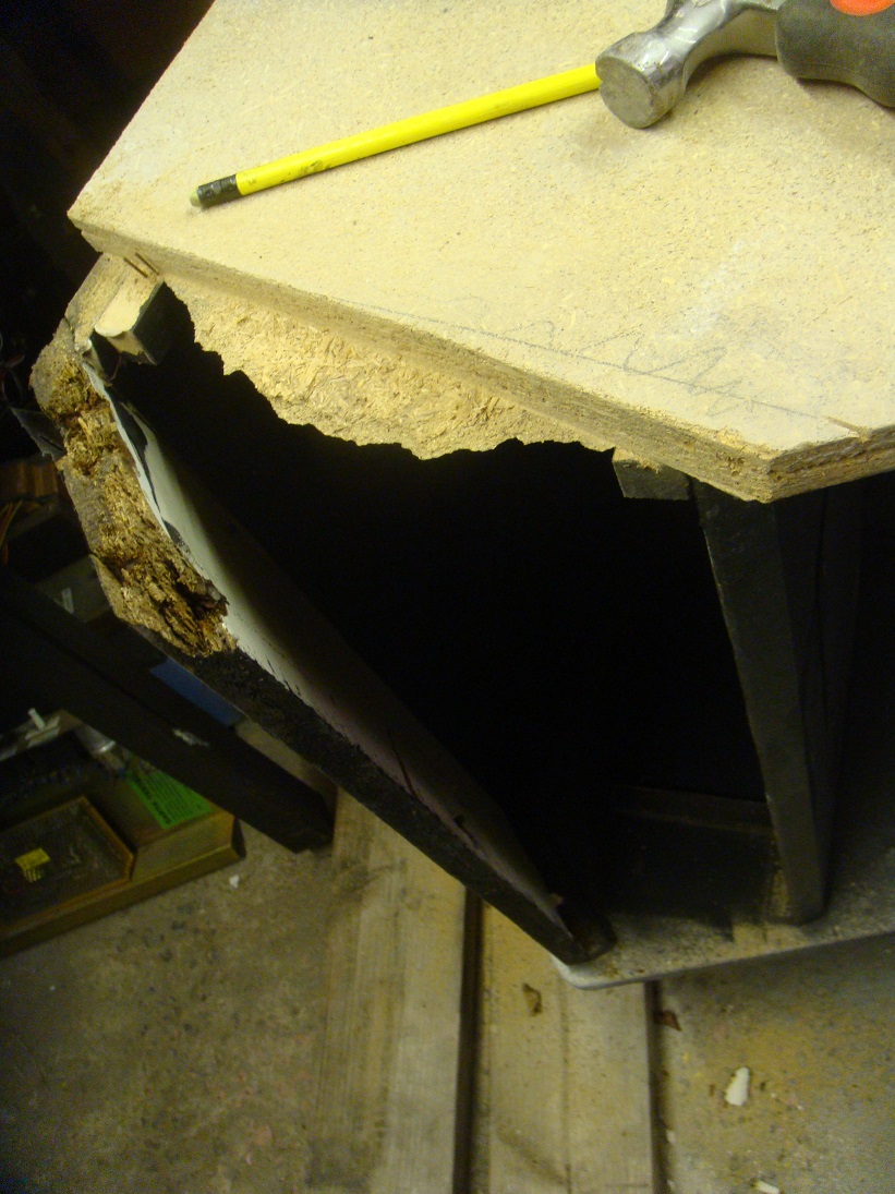

In hind sight I should have replaced the whole side! but had done to much to the bottom when I realized the top was just too far gone so had to amputate an ear and the top panel

The front panel had already been filled but was not a great job, this has black formica which was all chipped at the bottom, so I cut a strip back and will fill the wood below and put some chequered plate in it's place as a kick panel then paint it black. run out of filler just now, used more than I thought I would need on the side.

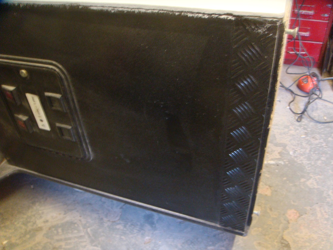

Been chipping away at this over the last few days, got the front panel filled and chequered plate cut fitted and painted, but dust is everywhere but you get the idea

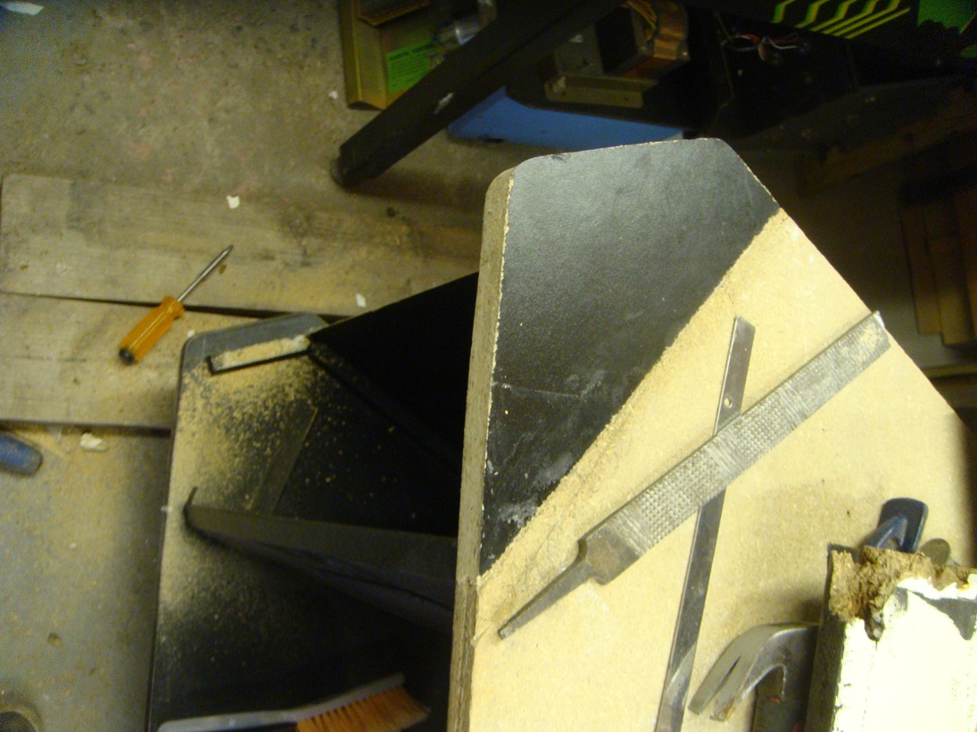

The side has been stripped to bare wood chip filled sanded and 2 undercoats applied, just needs a sand the ready for vinyl to be applied, the other side is in much better condition so I will leave the vinyl on, just give it a scuff and apply new vinyl.
