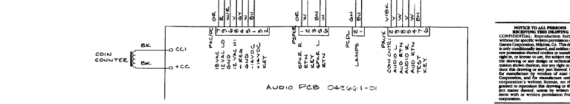

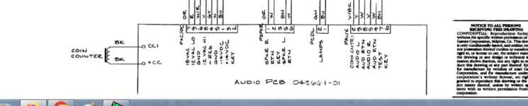

So it’s looking like j20 power on bottom board and j 15 are game specific with -15 and + which has been mentioned
Now to check champion ship sprint and trace to be sure

So this is info on Paperboy, not sure if needs all the voltages same on 720 as it doesn't have analogue pots like the other Sys2 games
To test and adjust the voltages for an Atari Paperboy arcade board, measure directly on the logic or CPU board to account for voltage drops.
+5V DC: Target 5.0v to 5.2v
+15V DC: Used for the sound/audio amplifier.
-15V DC: Used for the audio section and op-amps. (speech from what can make out)
-5V DC: Derived from the -15V rail and required for sound and control inputs
Unregulated 10.3V: Typically reads between 12v and 15v (this running high is normal)

Looking at the 720 schematics page 4a (which are most convenient for me to locate) it looks to make -5v from the -15v input.
I have dug out my test loom, which I haven't used in years (and very nasty it is too) unless a wire has dropped off the loom I only have connections for gnd, +5 and +15v (sub labelled by me as +12v). I was originally testing for a non booting CPU so probably never needed/cared about -5v for speech. I might find the time to plug it in to a variable PSU and see if it actually works on +12v or only +15v rather than me idly speculating about what voltage I stuffed down it. It's been a looong time since I used it.
Thanks Karl. Yes I agree it looks like the -5 comes from the -15v, so that should be covered. I will check I am getting -5 at the 7905 but I suspect I will be doing, and I have sound issues elsewhere
