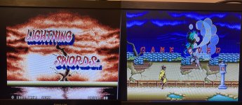

Just got Lightning Swords/Ken-Go running on the same Hammerin Harry Bootleg board I also converted to R-Type II ....
Looks like this board could be good for all IREM M84 (and possibly some M72 games) ....

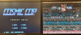

next up (hopefully) Cosmic Cop ......

Nice work. Understanding the bootleg is key to converting the original M84's. Hopefully everyone that bought an M84 Hammerin Harry may be able to change it to something else eventually
Jacmar
807CR
Converting the original should be easier than what I've done with the bootleg but this board cost about £35 and now runs Daiku, R-Type II, Lightning Swords and Cosmic Cop ... Off the top of my head I've not seen an original M84 for sale for under £300/400 so unless I find one for considerably cheaper I'll just to stick to the bootleg
