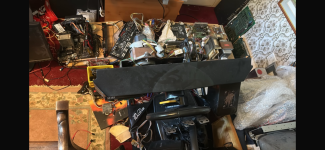

Lindbergh loader is something I’m trying to hook to og driving hardware .
I have a universal FFb set up to sega dash
All out on the floor
Pc left Universal FFb Sega
In middle Stuff right
Sega dash in front
All working with FFB from pc just need to lable up all connection before returning it to cabinet .
