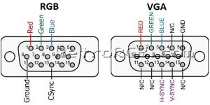

So from what you guys have said:
I’ll attach this to the rgbs cables that come out of the model 2.
The same projector works fine from the d-sub out of sega model 3 which I believe to be same resolution, unless that connector on model 3 does something different such as amplify the signal.
I am sure I have tried this with model 2 already,
It was at the start of lockdown, and I think my result was that the height was squished with black bars.
I guess I should wire to this diagram I found:
Copy the rgb?

I'd imagine that's because it's the same effect as wiring a JAMMA board straight into a TV
Model2 puts out 'TTL' level RGB, so up to 5V, and only expects an approx 1kohm load from the monitor.
VGA is 0.7V levels and a 75ohm load.
I had an op-amp circuit on mine so I didn't have any issues (which would be extreme brightness and excessive currents).
If it's displaying a steady image, but a funny shape, then I think it's just the projector being confused with the resolution and needing adjusting.
