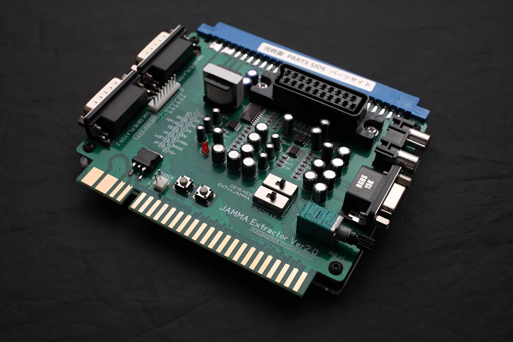

363CR
I have a couple of Betsu Betsu Jamma extractors that I use when I stream. Works very good, for scaling I use an OSSC and a GBSC.
For a couple cabinets I use Mr Video Jamma extractor but that is svideo and composite.
I feed the scalers to a cheap Hdmi switcher (4in 1out) and then a USB hdmi capture thingy.
Theese will soon be in stock, it is a friends webshop, I just have one of the prototypes of this reworked version.
Feel free to drop me a DM if you have any questions, but I am not expert when it comes to techy stuff or the English language :D

Just ordered one.. thanks!
