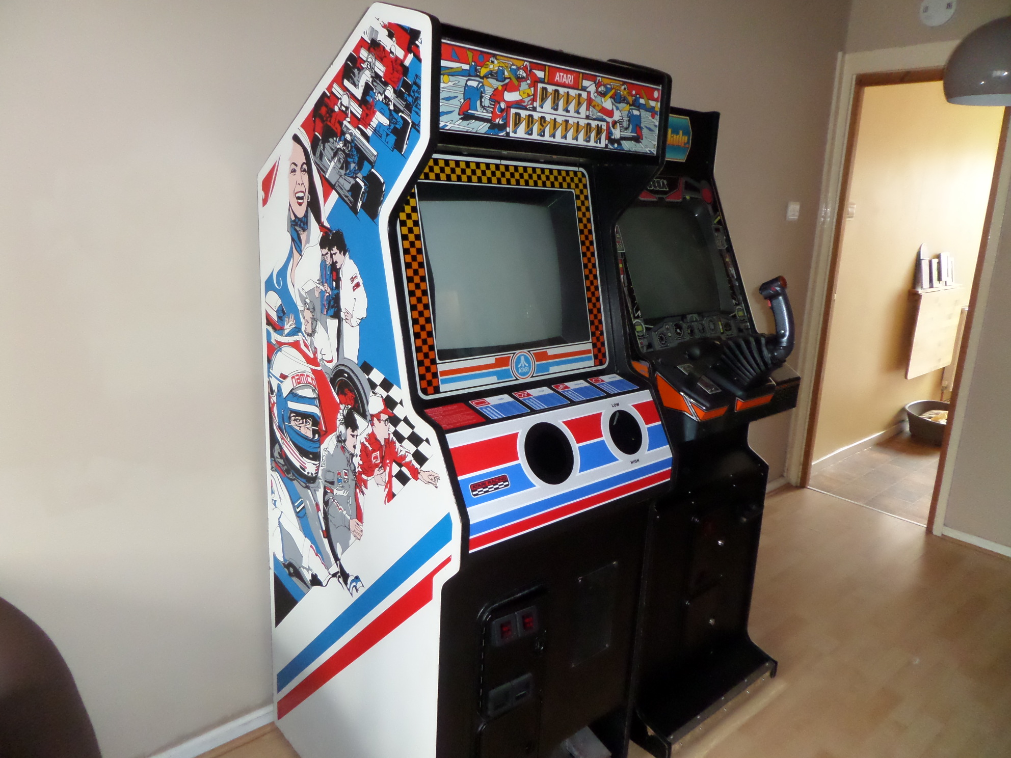

Just got this delivered today. It's a solid cab, and the condition is fantastic considering it's age and use. Slightly unhappy, as turned up missing the back door! Oh well I'll worry about that later.
I must be the most impatient person on here, as no sooner had martin left, I was already cleaning and hoovering it out!
Unfortunately the insides aren't as good as the outside. Will need the usual AR2 full rebuild, power brick strip down etc.
It has the wrong marquee fitted, but came with the original, which fell apart as soon as I touched it. Will order new one from muddy. All parts are included, and were only removed, to powdercoat the control panel etc.
New decal has already been fitted, and the coin doors have been powder coated.
Still has the original burn free monitor. Lots of loose wires etc. I'm not even going to switch on, until I have rebuild everything, and checked all the voltages. Will post more when I get started on the insides.

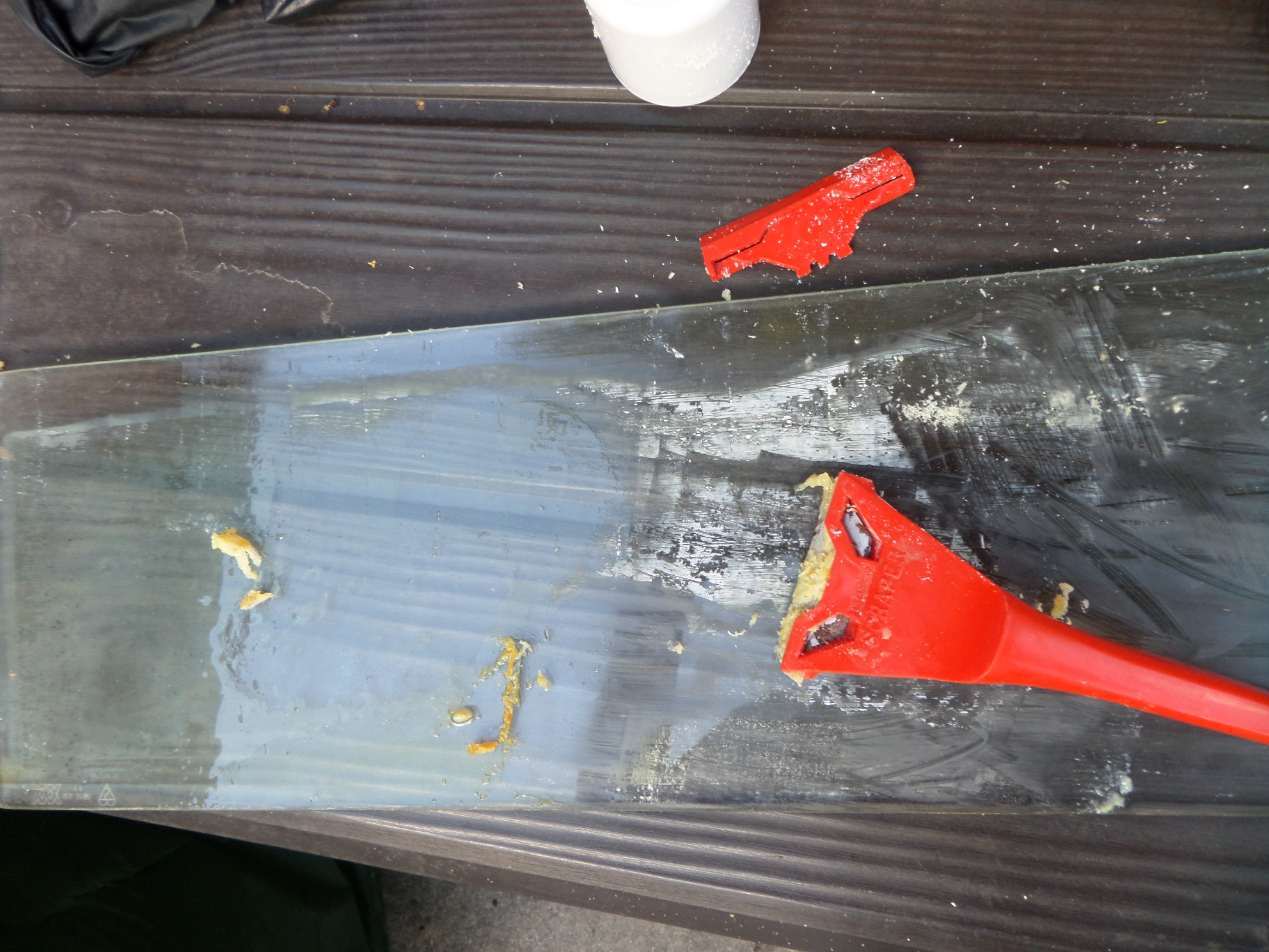

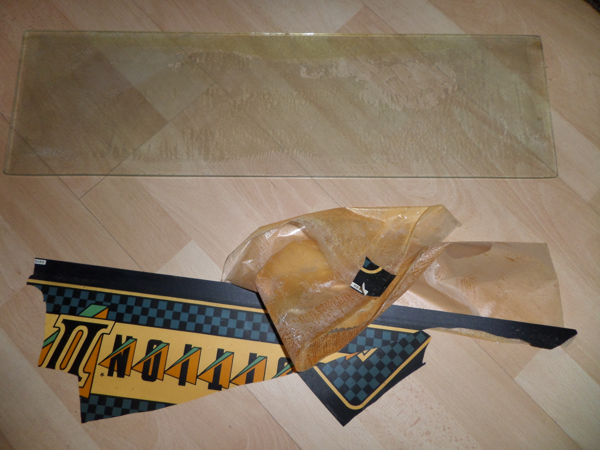

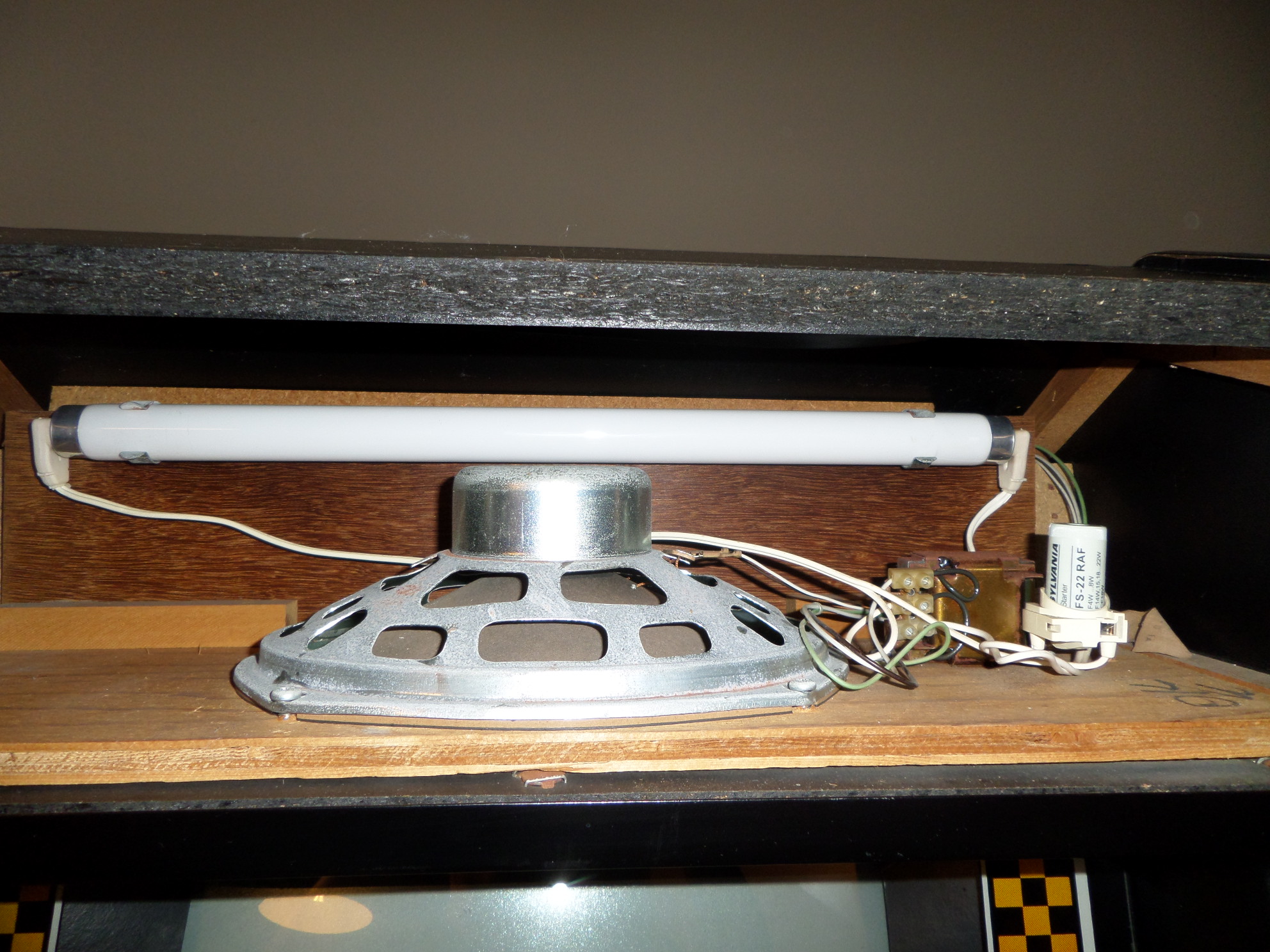

Got bored today, so started on the marquee. New tube & starter fitted. Next to tackle the marquee glass. What a mess!
Not much left of it. Backing glue, stuck on glass nearly 40 years, so soaked in label remover, and used a stanley blade scraper.
After a lot of effort, and finishing off with glass cleaner and IPA, the original glass came up like new. Just need to order a new marquee, and that should be all done.

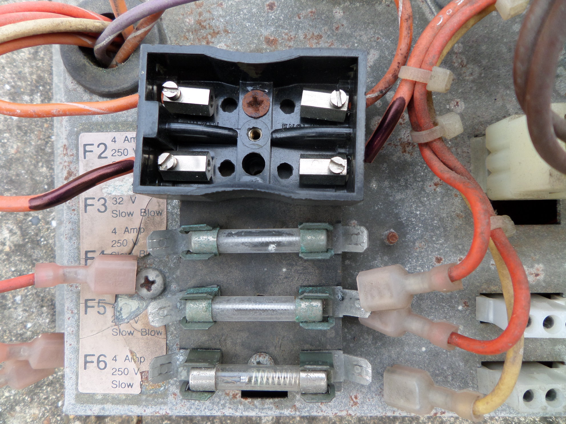

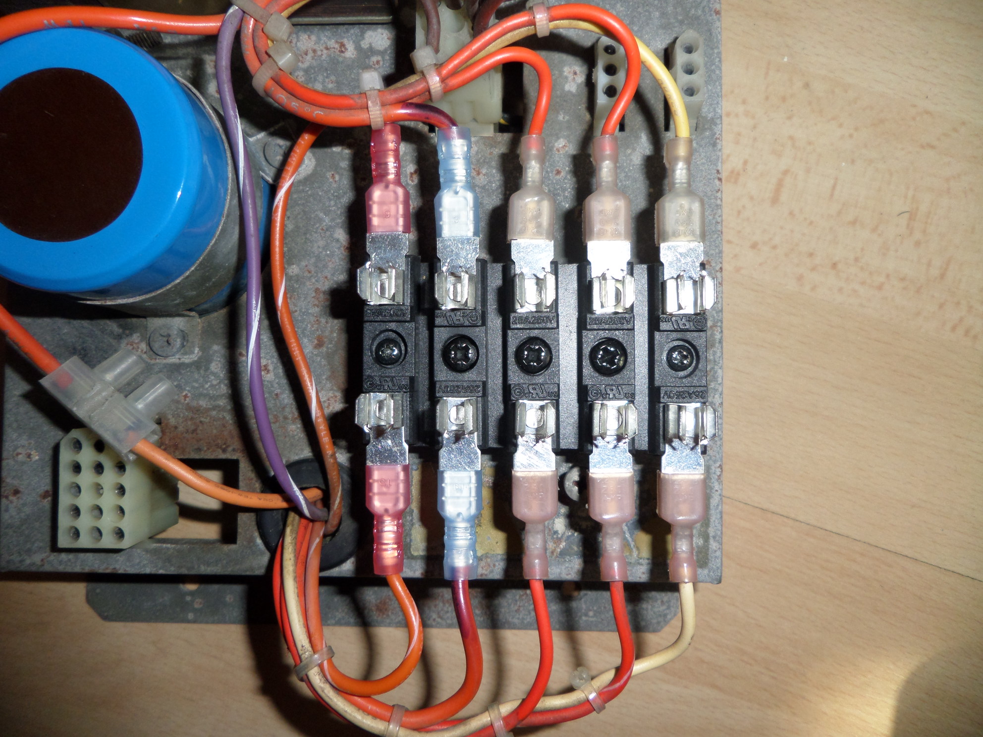

Fuse block has had a serious hack done on it. 2 of the clips had burnt off.
I couldn't find a replacement, so drilled out all the remaining fuse clips, and mounted some new holders, to the existing base.
Fitted some spacers underneath, as screws on plate, would interfere with the bottom of fuse holder base.
Even matched the original spade connectors. All finished on the fuse block.
