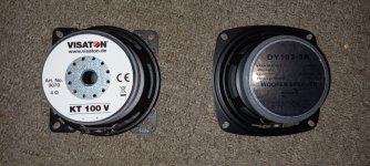

The Dynavox DY103-9A has previously been mentioned as an alternative, but I hadn't seen any feedback on this to confirm it was any good. However, looking closely at the specs and images, it appeared to be a slightly better option:

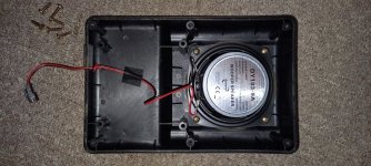

I had been a bit concerned that the 4 tabbed mounting frame design of the Visaton meant that there was a gap around the mounting ring on the woofer box, but it didn't seem to be an issue on Daytona 2. The Dynavox has a fuller frame, more like the original and looked like it might cover the mounting ring and provide a more airtight fit.
Bad photos, sorry..

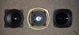

Turns out it does fit a lot better, although you do have to turn the speaker 90 degrees as the connector lugs are quite wide apart and the wires don't quite reach the original location (you could pull the wires more through into the woofer box, but I didn't). The spade connectors also need pinching in slightly as they are a bit too open for the smaller lugs on the Dynavox. Finally there is a very small plastic guide peg you have to snip off from the woofer box to get a flush fit on the mounting ring (there is a matching hole in the orignal speaker frame that ensures correct fitting, but it's not necessary and gets in the way when fitting the Dynavox).
Note the better ring coverage.. :p
So, all back together, fire up and wow, what a difference! The sound is a milllion miles better than the Visaton and back to the same quality that came out of the original. Good strong bass and a really good upgrade on the original cab (initial D and OutRun2 cabs never came with sub woofers out of the factory - UK or Japanese).
