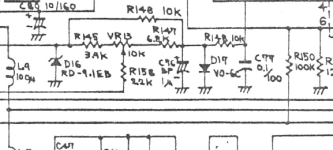

Found a 10k pot but it's too big for the board! I removed VR13 sprayed it with contact cleaner and metered it, seems smooth up and down the ohms, put it back and retested, so turning it anti clockwise increases the brightness and vice versa, making it brighter means I can turn down VR12 (brightness) and get a decent luminace, but I'm still seeing the issue however turning VR13 back and fourth mimics what I'm seeing as the fault, so either the pot is flaky or something related to that pot!

Q25 and VR13 are in the ABL circuit which uses the lower end of the flyback tripler to monitor the beam current (not sure it was a good idea to turn VR13 which was factory adjusted and sealed). One end of the VR13 pot is connected to the flyback pin through R147 and R148. The other end is tied to the 12V line through L9 and R141. The zener D16 regulates the voltage to 9.1V which goes to the other end of VR13 through R145. Check that you have about 9V on the cathode and if that checks out, test D17.
Thank you, I will check that out, I just had it on for a few hours and it never done it that I saw, Would I need to be reading D19 while the screen was flickering?
