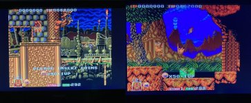

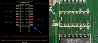

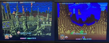

With activity all over the graphics RAM and ROMs I went looking for more TTL which may have obviously failed ... found a LS367 buffer @ U36 which had one of its outputs stuck to ground, despite a toggling input and the chip always enabled ... you can see it here on the slice test result, so it was removed and replaced ...
Which didn't make too much difference graphically ... before (below left) and after (below right) ....
But no noticeable change to gameplay scenes so didn't feel like this fix accomplished much ... but probably another one of those little fixes you don't see the true benefit of at the time because other problems are hiding it ...

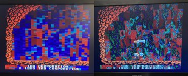

I did get some improvements on screen when I removed the FG Tiles ROMs ... I could actually see the correct background during the opening scene ....
And this sent me down the rabbit hole of checking everything I could find, to do with those ROMs ... and spent a good few hours on that but couldn't find anything wrong ... Frustrated and not sure where to look next I decided to sort a few other things that I'd put on the back burner ...

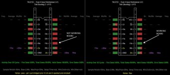

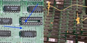

Secondly I had marked a LS153 @ U113 which I knew I had damaged back when the game wasn't booting .. I remember the little spark and pop when I accidentally bridged a couple of it's pins, but I knew it was just a chip in the video section and not responsible for the game not booting, I also Slice tested it at the time to see how bad it was and it passed! Ok then I obviously didn't completely murder it so it can't be causing to much chaos, so I marked it at the time with a little piece of yellow tape (you can see it on the above pic) and I thought I'll come back to that ... then kind of forgot about it while down other rabbit holes ... so had another look at it because I was thinking it surely can't be ok, it can't spark and pop and still be ok can it ? Signals looked fine on the scope and the pins I remembered bridging were unused ones (or so I thought) .... Let's double check ... so I got the working board out and Sliced that same chip ... here's the results from the 2 boards .... the bad chip I fried is below on the left, the working board one is on the right .....
You can see why that result (on the left) on it's own would not raise suspicion ... Just looks like that input on pin 11 is not being used ...
But alongside analysis of the same chip on the working board, you can see what I'd done, I'd bridged pins 11 (GND) and 12 (+5v) ... blew the line and lost that ground signal on pin 11. This was confirmed when I removed the chip and saw the blown trace ...
Put in a socket and replacement LS153, powered up and thought I'd cracked it ....
But soon realised all was still not well .....
Now I've got perfect Background tiles and no Foreground tiles ... pretty much the opposite of before! ... while still the sprites tiles are chopped up and separated ...

Before ripping out any other IC's I had been thinking about the sprite issue ... I know for a fact the sprite generating top pcb is 100% working ( I have 2 of these now fully working) so my thinking here is that for the sprites to be messed up then it has to be either a signal (or signals) not getting to the sprite board OR the data going missing once it comes back onto the main pcb ... so I grab the multimeter and work my way along the pins of the single connector which joins the 2 pcb's and it did not take long at all to find one of the connector pins did not have continuity to the LS245 (pin 4) @ U77 ... (again, without schematics, the beauty of having a fully working set made this sooo much easier)
Yet again this is a socketed chip from someone's previous repair attempt and yet again they have either lifted a pad or ripped out a via and lost the continuity from the pin to a via just above the chip. I didn't remove this socket (thinking now maybe I should've) I just did a small repair wire on the solder side of the board to restore the connection ... and fixed the sprites (y)

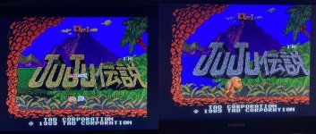

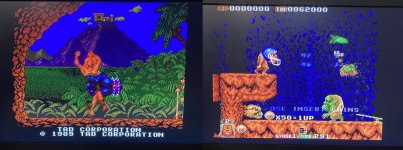

There is now only ONE small graphical anomaly left on this board set and I'm yet to get to the bottom of it ... there is a palette problem ... the JUJU logo (and clouds and building above) should not be yellow like that (pic below left) and the end of level boss should also not be yellow at all (below right) ...
I've been down a palette rabbit hole with this ... There are 2x palette RAM (2148 and a 6116) and the 6116 had been socketed previously so I thought here we go again, another bad socket job and that'll be that, but I replaced that and no change ...
Then I thought it was a blue problem for 2 reasons ... firstly because at every transition between scenes in the attract mode the screen flashes blue twice (not normal) and secondly because grey is equal RGB but a lack of blue in the mix (weak/missing line) would yellow the colour ... so I replaced the LS174 which latches the palette data before feeding it to the (Blue) resistor array at the jamma edge ... but it made no difference ...
Maybe the other palette RAM (2148) has gone wonky .... nope replaced that and no difference made .... ok the 2x LS245's that buffer the palette ram data @U23 and U24 had also previously been replaced but they weren't socketed and it looked a better solder job maybe done by someone else a bit more skilled ... but I'm taking no chances and removed and replaced those but still no difference ....
Then I realised it wasn't just a shade or two of grey that were now yellow, there was brown in one spot where there should be dark blue/purple and some green bits where again they should be grey .... so I'm now wondering if it's a palette ram WRITE problem, where each time the cpu writes the palette data into ram at each transition, maybe one data bit is missing/stuck and leading to incorrect writes to the palette ram. It would make sense, a lot of the colours are perfect, it's just a few are wrong ....
So I'm back to suspecting the IC's in the shared cpu data bus, the ones previously socketed and where I've already found at least one issue (marked in red above) .... I've marked above (in green) the Palette Ram IC's which I've changed and checked, all this seems to be ok ....

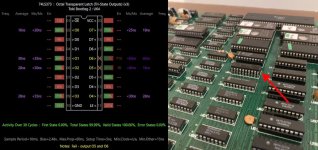

Well I found the problem IC ..... and it wasn't one of the ones marked in red above .... I don't know what made this pop back into my head but I was thinking about a stuck signal somewhere and had a memory from back when I changed the 5x LS245's at the jamma edge which were all showing bad ...
I remembered after changing those, all seemed well apart from one DIP was stuck on OFF ... It meant you get 2 lives per game, no big deal, and probably because I had bigger issues then, like messed up FG, BG Tiles and Sprites all over the place I moved on pretty quickly to chasing down those major faults.
Also since then I'd pushed all the dipswitches to the OFF position and so hadn't been reminded of this since (because all would show OFF on the boot screen) ... so I went through my photo's from then and found the one I was looking for ...
So I check this again today, push all the DIPs to ON and DIPSWITCH Bank 2 (the lower one on pic above) switch 2 is still stuck OFF ! ( DIPSWITCH Bank 1, switch 4 is working fine) So I check the physical switch - GOOD, the 1K pull up resistor array it's connected to - GOOD, so then I trace that signal ... it's read (by the cpu) from pin 3 on the connected LS245 and I check continuity to all chips on the board and write them down (on my good board) then cross check with this board - and all continuity is there, and no continuity to anything there shouldn't be ! ... Interestingly this signal also goes to one of the palette ram buffers ... so I'm sure I'm on the right track ...
SO this signal goes to 5 other IC's ... 4x LS245's and 1x LS373 ... the 245's have already been replaced/socketed (3 by me, 1 by someone else) and the LS373 is still original ... I removed the 245's one at a time ... rebooting and checking the dipswitch and none of the 245's made any difference, all that was left was the LS373 @ U64 ... the signal in question connects to this on pin 17 input ... sliced result below, and piggybacked ...
Chip must've partially failed internally between pins 16 and 17 (possibly 14 and 15 too?) , maybe a bit of a leak to ground ?? So one corrupted shared data bit, caused by this failing LS373 output stage which broke one DIP read, corrupted the palette RAM writes during transitions and caused selective colour substitution faults across all layers !!!

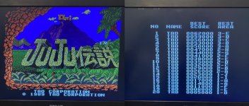

Now all graphics are 100% ... see before and after below !
Audio is also working fine ( I refitted the YM3014 DAC that had fell out the board at the start of this repair) so now this board set is also 100% fixed ... it's been a long one getting both these 2 board sets fixed ... but it's been another really good learning experience ... probably worth a summary for anyone reading ... so I'll do that soon ...
