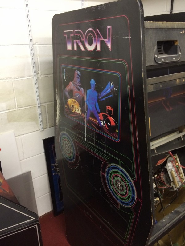

Here is how she arrived. The cab is absolutely solid; there are no chunks, dings, damage or damp to speak of; not even around the base. It is a great starting point for a resto
Right-hand side: The usual front edge wear and tear on the side art where people have been leaning on the machine, together with a few scrapes and people's initials. Part of me thinks 'Replace this!', whilst the other half thinks 'Leave it; it's original and those are people's memories.' We'll see.

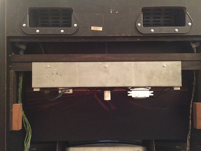

Rear view: You can see the dangling power cable here for the missing (!) light fitting; 'Where am I going to get one of those from?!' I cried

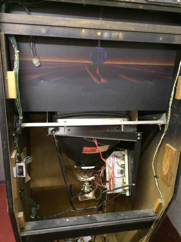

The backdrop is intact and stapled in place; it's just a bit dusty; those marks on the right are spider droppings and wiped clean off
The monitor is not original, being a Hanty of some description but it does work. One of the first jobs I do is take that out and start doing research into what monitor(s) TRON shipped with.

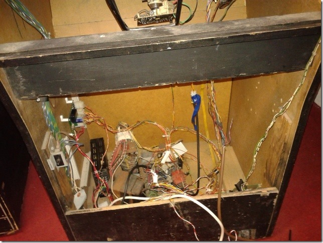

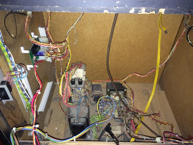

Inside bottom: The cab is wired for UK 240v but unfortunately the harness has been quite badly hacked. I knew about this from discussing it with the seller so no nasty surprises but again, one of the first things I do is to remove the hacked loom in its entirety. The PCB stack has already been removed and wrapped safely in a million layers of anti-static bubble wrap
You can see the switcher conversion kit wired in on the left too, which was a nice bonus...

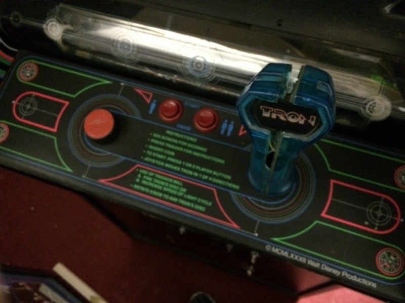

Control Panel: The overlay is very nice and still pretty vibrant, with no tears. It seems the punter's frustration has instead been taken out on the joystick and the spinner

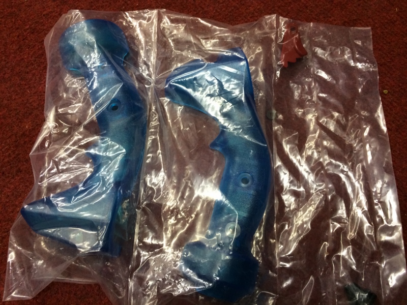

The joystick is firm and springs back to the centre perfectly but the plastic covers are taped together and the trigger is missing. I am not worried at all for reasons that will become apparent though
The main black light cover is faded but there *is* a light present so the fitting is all there. Good. I am not sure if the red buttons are stock though; anyone? Should they be white? It would also be useful to know if the spinner art that you can obtain from Phoenix Arcade is after market or if the cab did indeed ship with more than just an orange sticker?

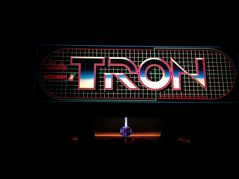

Marquee: This is original for sure but sadly there is some bubbling where the print is coming away. It lights up and displays well enough however

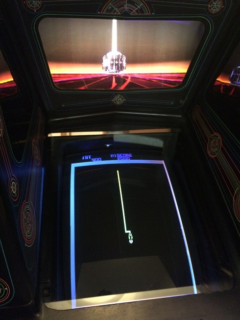

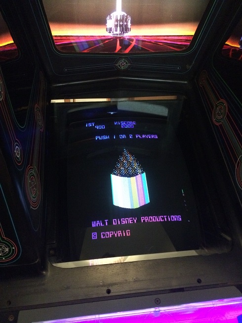

Power on: This is what happened when the cab was powered on and again, totally in line with what the seller had told me to expect. The cab boots to a white screen and a cycling / clicking sound can be heard coming from the speakers when the volume is turned up. We have a long way to go people!

My approach to the hacked loom as
I’ve previously stated was to rip it out completely; there would be none of
this testing for continuity, breaks, damaged wiring, connectors hanging half
off or other such technicalities. No, the PCB wasn’t booting so my approach was
from day one to remove the entire internals and get replacements; the PCB
stack, power brick, the CP loom, main harness…..everything. Now TRON parts are

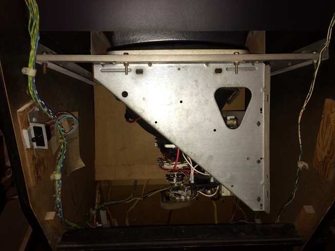

Nevertheless, I unpacked
everything, gave it a damn good Jodo-style clean, laid everything out and
identified which cables went where by staring at other people’s TRON cabs on
the net to see how the wiring fitted into the shell. I decided to clean the
shell inside and out before I installed the new wiring, so I removed the rear
screen, coin door assembly and control panel, plus the light fittings that were
thankfully present underneath. I also removed the marquee and it was then that
I discovered something. The marquee light assembly looked odd. It was too
squared off and slightly smaller and thinner than a standard lighting setup.
That’s because it’s not a marquee assembly; it’s the assembly from the
rear of the cab that you thought was missing
” said the voices in my head.
Yes, that’s right; a previous
owner had for some reason removed the rear light fitting from behind the
backdrop and re-fitted it behind the marquee! Happy days! This moment could
only be improved by me logging onto http://thearcadeboneyard.com/
and finding an actual marquee light fitting for TRON and buying that, therefore
making a complete set of lighting fittings for my cab. Which is exactly what I
did immediately afterwards.

A couple of boring pictures to show the new loom (partially) back in the cab, (switcher not pictured) and the 'missing' rear light fitting back where it should be with the new 50hz ballast and starter fitted.
John Bud took these.
Don't blame me.

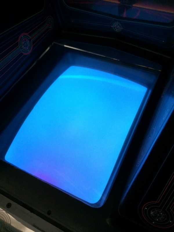

So

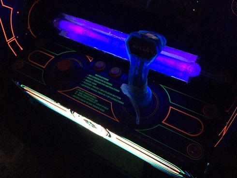

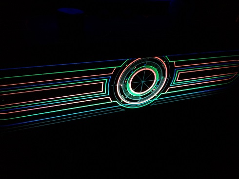

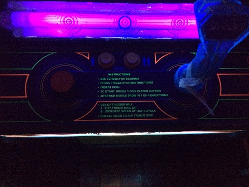

where are we right now? Well all of the lights are back in and working,
apart from one. The front lower black light white simply refuses to
come on. Voltages are good, the new ballasts are fitted correctly, as is
the new starter. There is only one option really.
If you can find him. If you can convince him to help...maybe you can hire Mitchell Gant nip over to Neil's workshop.
I
find Neil to be his usual enthusiastic self. When I arrive with the
poorly light fitting he is already hooking up his tools and making
things electrically arc to other things....because he can. It's become
somewhat of a routine now; Neil assumes the position of extreme danger
holding a probe of some description in each hand. I hide behind
something.
"Ready!" I shout, and pull down my goggles.
BANG! There is a bright flash.
"I think your brand new starter is dead. Let's try another one." says Neil.
Sure
enough, with a different starter borrowed from Neil's overhead light
(!), the light bursts into life. It transpires that out of the 8 new
starters I purchased, 2 are bad. Who'd have thought it? Neil and I chat
for a while about black holes, quantum physics and dirty voltages before
we part ways. He's a good egg.
So I now have all 4 lights working and that's the first major milestone achieved! I freakin' love the way that the backdrop reflects around the inner shroud on TRON...

Back at home and after a brief period spent swapping over the old versus new switcher, I pull out my new toy and start measuring.
Everything is perfect; 5v and 12v are rock solid and they remain that way for the 15-20 minutes I let the cab run for. There is absolutely no sign of any fluctuations or increase in voltage. Now the great thing about also having a TRON cocktail is that I have a confirmed working board set to test!
It's time.
Victory Dance! http://youtu.be/2AIRQZAgtaE

By the way, out of interest, how well does the cocktail play with that weird ball joystick/trigger combination?
DaveSpicer2015-02-25 00:58:41
Jodo
Boy is this a machine!
607CR
DaveSpicer said:
Come on Phil, when's the next exciting episode due?
Soon Dave, soon. OK I have man flu
The cocktail joysticks play fine; they are noticeably tighter, which gives the illusion of being more responsive but the many horror stories about it being uncomfortable or difficult to play the cocktail are from my own experience not true.
