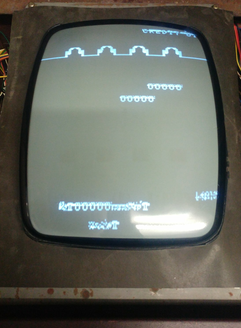

I saw in the earlier picture that you are using a TL866 programmer, are you sure this programmer drives enough current to power the hungry old eproms? In my experience those programmers are extremely unreliable to read old eproms, never alone program them.

I believe it did program them ok. I run a comparison after each burn and before the 2nd run of burning and the read was the same as the rom file im using.

I've doubled up the code on the Sound EPROM. Started it up and I have the same screen as above. Gave it a credit and the game tried to play and I got a nice start-up song completely different to the Space Fever. The game didn't play though and I just got garbage on the screen.
Downloaded another rom set but the code is the same as what I already had.
Next task is to erase the EPROMs and burn the Space Fever ROMs to the 2716s. See if it just the program or my adapters. Adapter for the sound seems ok though.
