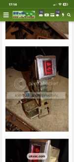

Looking at the internals from the reference machine which is the same machine, the psu looks to have been changed at some point going by the choc block connectors! also the edge connector on the left looks to be the same now as was in the below pic, So I might just rewire that and leave where it is and make up a finger board to suit the firebird boardset, The dilema is do I use a Nintendo boardset with all those little connector plugs (looks like it did have one fitted?) or do I use a bootleg set with edge connector? I have both I could use, decisions!
Looking at the pic again the edge connector looks to be a small pcb no idea what that might be, maybe a video inverter for the weird sync these boards have? Ideas welcome?
