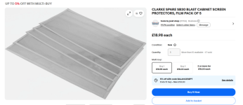

2. The window gets misted up pretty quick so I just asked Google and An acetate sheet inside a shot blasting cabinet typically lasts anywhere from a few hours to a couple of weeks, depending heavily on how often you blast and the type of abrasive media you use
Factors That Affect Lifespan
    • Type of Abrasive: Aggressive and hard media like aluminum oxide or silicon carbide will frost, pit, and wear through thin acetate very quickly (often within a few hours of active blasting). Softer media like glass beads or plastic/organic abrasives allow the sheet to last longer.
    • Blast Pressure: Higher PSI accelerates the abrasive wear on the sacrificial layer.
    • Static and Dust: Fine dust can cling to the acetate via static electricity, reducing visibility even before the sheet is physically pitted through, prompting a replacement for clarity
    • Because acetate sheets are very cheap and easy to cut from rolls or overhead projector sheets, many operators treat them as a disposable daily or weekly consumable, swapping them out as soon as visibility becomes cloudy or fogged.
5,283CR
That was doing my head in with the dots
CHEAP :LOL: this is why I wondered if I was doing something wrong as I wasn't gonna be replacing that every week at cost they are. probably save money if you can buy a roll, then need thin double sided tape and spend time cutting and sticking tape on them

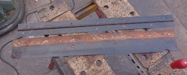

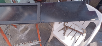

This was all doing my head in so was time to make things easier so lets make the window open save using the stupid side door and make it easier to stick new sheet on the inside
With some spare metal from a sega driving machine twin topper i used the metal for a frame to fix the window to
Hinge came from arcade machine, might have been of the bodged up Star Wars from the AfterBurner panel
Rivet Nuts around the sides to bolt the window frame back to this
Since fitting the opening window I hardly used the side door as it's much easier with top opening unless I need to get something bigger in
It's still not easy putting pallet wrap over the window, be better if it folded over flat so its upside down, but I just put it over the opening and then close window, the right hand glove is falling apart so I put my hand through the gap but I was thinking of making a little door between the holes to do it and also to use for small items save opening the top but not got around to that yet
