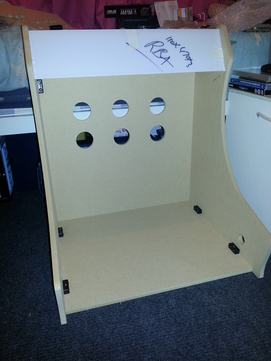

inside it will be a 19" monitor, and to run hyperspin i'll be using: Asus AM1M-A Socket AM1 VGA DVI HDMI 8-Channel HD Audio mATX Motherboard, AMD Athlon 5150 1.6GHz Socket AM1 2MB L2 Cache, Seagate 1tb Sata HDD, 2gb DDR3 Ram, Windows XP OS

I brought one from him it was a standup and it arrived being the proto he used on his listing
the MDF was frayed, the MDF had holes in it from the connector blocks, and couldn't be re screwed in as MDF frays if you try to rescrew into it
and he just eventually stopped responding to my emails and it was gonna cost me more to resend back to him than to just keep it
the conclusion was just don't deal with the guy
tb2000
3,150CR
The joiner blocks are fine for quickness (they're the same sort of thing they use in kitchen cabinets and other flat-packed stuff by the looks of it). They're probably ok if the unit isn't going to be picked up and moved too often. I think i'd probably add to the strength a bit though by drilling a few holes here and there and using wood glue and dowels. Doesn't make it easy to get back apart though but I don't suppose that matters really!
oh yeah connector blocks aren't really the ideal thing to use
my main annoyance was that he sent me is already assembled and photographed piece when I in fact paid for a NEW item
oh and the bottom piece was missing which I had to cut a new and also nothing to mount the monitor was present either

yes I bought one from Rich, it was ok...
the blocks are not strong enough for the thickness of the wood, you have to use really short screws which are no good, so it was kinda falling apart as I was building it, instead I drilled straight through and used coach bolts,, there was also no instructions so I had to put it together like a jigsaw, not hard for me but for other people who have never worked on arcade machines etc before I'm guessing they wouldn't be too happy, there was also 1 piece missing, can't remember which piece now but something was amiss?
He's also bought the really cheap buttons off ebay and drilled the holes for these, but the really cheap buttons are smaller then the normal ones, luckily I had some so I knew what he'd done, its also impossible to re-drill bigger holes
apart from these 3 issues = connecting blocks no good, holes too small, no instructions, it was ok for the money,,
There's a good market out there for these kits, and I reckon if someone had the enthusiasm to build these properly, and post them all ready built, someone could make more money then they are getting at the moment
