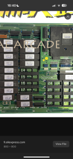

I'm not Cps1 guru and it's only my opinion but it could possibly be a conversion if it's running Hyper fighting. If so it's a pretty good one by the looks of it. If it's the us/euro version it should have mask roms. The C board sticker looks wrong for the Jap version. It does look very similar the CE pictured above tho so i could be talking complete nonsense. Happy to be educated by a cps nut.
Here's my Jap one (Is it fully legit? I really couldn't say for sure but it looks right to me)
Here's the pic from aliexpress of one
That could even be a pic of a real one they are using. It looks very similar to yours.
TheDaddy
14 (93%)
7,034CR
I agree , The sticker on the C board actually belongs to the Audio rom , Unsure why it was placed on the C board !
