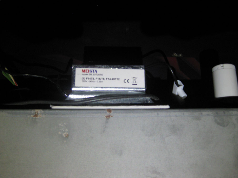

Can you post up a couple of pictures of the new 50hz ballasts - ideally of all the writing on the front - so I can see if I can match them over here going forwards?

Ok willdo later, they are slightly deeper in size to the US ballasts that means that the cover over the lower blue flourescent won't attach but it isn't a problem. They come with a heat resistant pad that I fitted although they don't get hot.

Here is a (rotated) pic of the ballast that came from Stamann Musikboxen:
The writing says:
MEISTA
model SB 20/120/50
(1) F14T8, F15/T8, F14-20T12
120V - 50Hz - 0.35A
