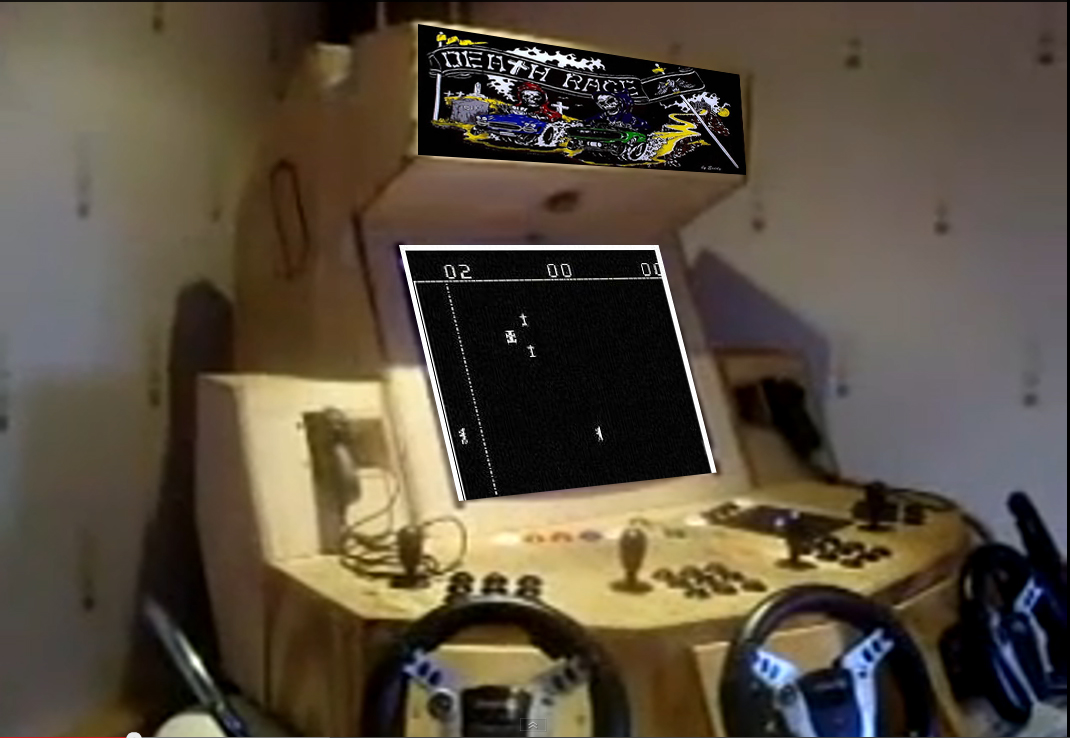

virtvic said:
How dare you. Mine has 2 track balls
We need pics you bloody tease.
Good on ya olly proper piss take
