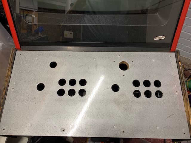

Hi,
I have a Killer Instinct 2 control deck that was converted to a Turkey Hunter which I am converting back.
When it was converted they drilled out a hole in the metal overlay on the control deck. I want to repair this and have found the following product:
https://www.amazon.co.uk/Evo-Stik-320123-Metal-Epoxy-Putty/dp/B00361819W?th=1
Would this do the job? Has anyone used anything else?
Thanks

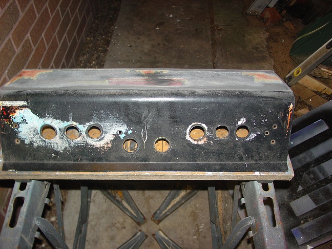

I've used metal epoxy before to do this. I filed down the top-side edges of the hole (to give filler a better key) then glued a small metal plate to the underside. Then filled the hole with P38. Tip: scratch up the bonding surfaces and put a bead of glue all around the plate edges. At first, I had the bonding surfaces sanded smooth, but the plate fell of when I dropped the CP onto my workbench.
Titchgamer
123CR
I have used the above method before to, Only difference was I welded a plate underneath instead of glued then filled with P38 and sanded.
