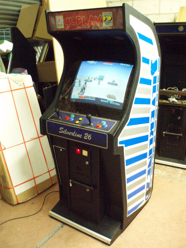

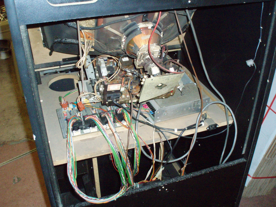

I had one that I sold around 2013
the only pictures I can find are these
IIRC I sold it to James Brindle / Andy Palmer, think they said they were going to use it as a test rig?
not sure who has it now, or if it's since been passed on to someone else?

Honestly this helped more than you could realise.
I’ve worked out the right connectors (Molex MLX for power and Mini Mate n lok for game changing) and alongside an image that cools found for me, I’ve managed to work out the wiring scheme too!
