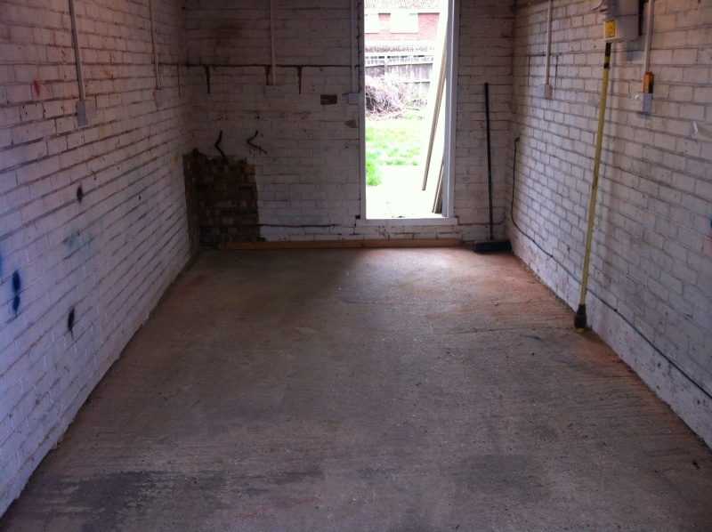

Before

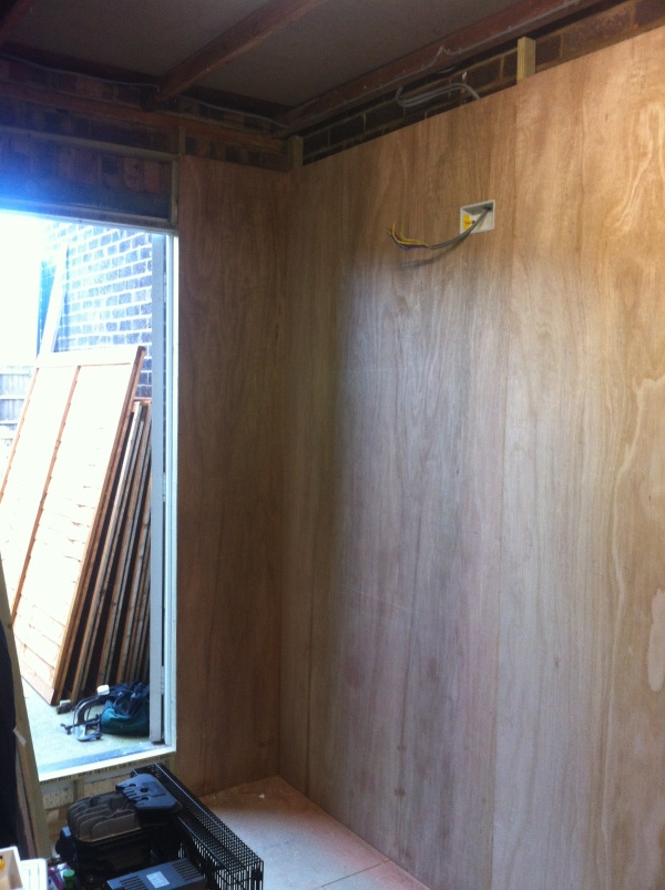

So far its cost me about £450 in materials, floor has been raised & insulated slightly (only about 1.5 inches and the walls are covered in 50mm Celotex insulation and then 3mm ply over the top to cut down on wasted space, the celotex was free so had to stick with what I was given.
I still have the final wall to finish but this is covered in pipes & Cables that need to be boxed in & i need to put in a suspended ceiling as the garage walls are over 9 feet high so I can hide the tops of the wall framing etc.
More pics when I can spend some more time sorting it out.

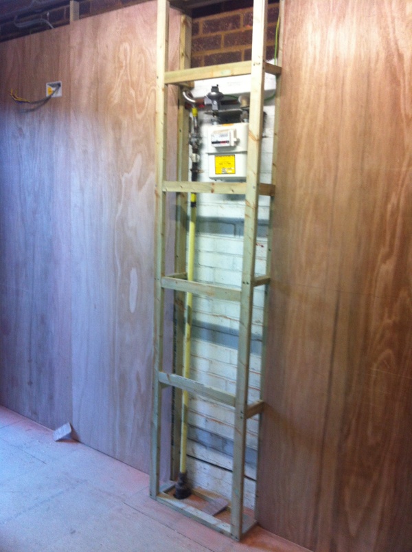

Some more progress last night.
Bloody Gas meter in the way so boxing it in and will put a little access door in later.
Just one more section of wall to do (frame is all done)and it will nearly be ready for painting.
I've been given a load of light purple floor tiles so these will be going down on the floor & was thinking of just painting the walls white.. unless someone can recommend a better colour for the walls :)

Your gonna need to stick a couple of vents on the boxing of the gas meter, your not supposed to run gas pipework in unventillated voids, and make sure it's atleast 150mm between any gas pipe and sockets and 25mm between pipe and cables.
Sorry went into heating engineer mode there

Thanks for the heads up Chappy :) although it will be vented at the top I may add something extra in,
Think im safe with the sockets & pipe distances as ive moved them further apart than they were before they were installed by the trades.

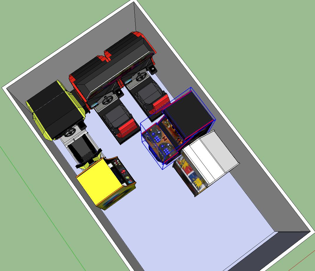

Hi

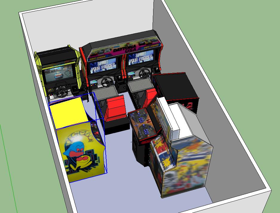

A quick Sketchup plan with some rough measurements.
not settled for any kind of placement yet but will be something like this.
Out of interest has anyone managed to find a Naomi Universal model so I can complete the model ?
I've also had to use a Daytona 2 single model to use in place of an ID3 cab.
hopefully get the floor down tomorrow.

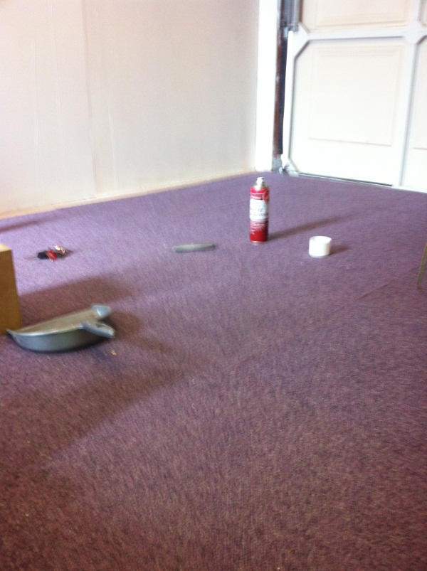

So after 4 hours in the garage today we have the floor down.

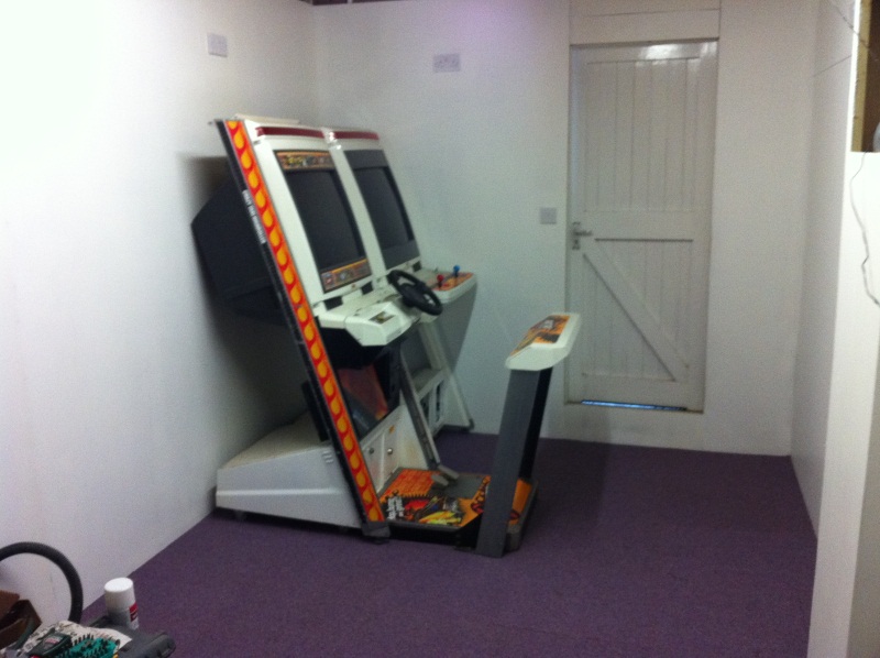

And couldn't resist moving these into place.
