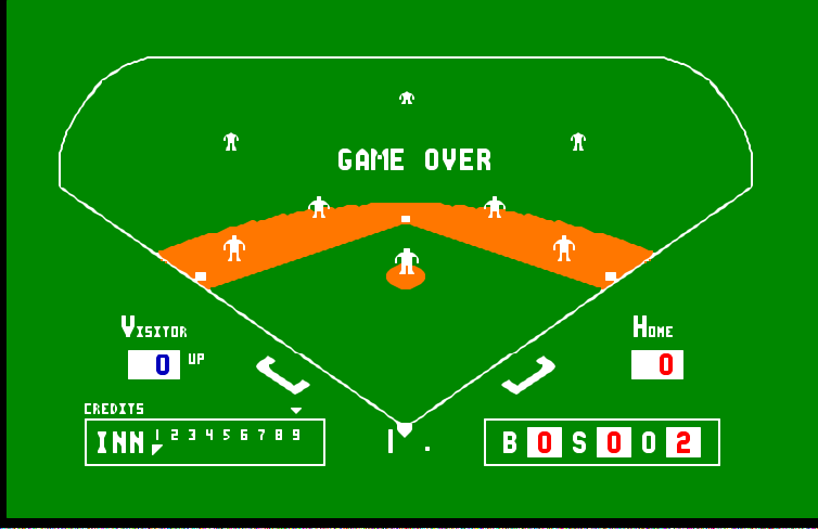

I am currently working on putting Arcade Astrocade into Mister and have two games running (no sound on Seawolf II since it's all discrete - will
add that later) - Now adding
the pattern board code (aka Blitter - for Space Zap onwards)

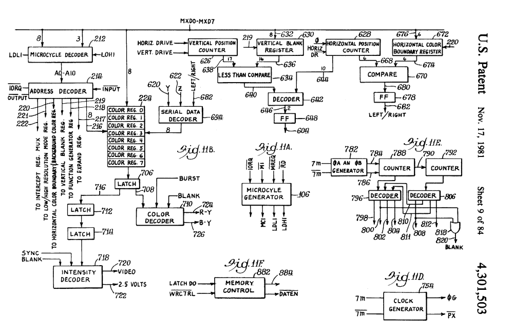

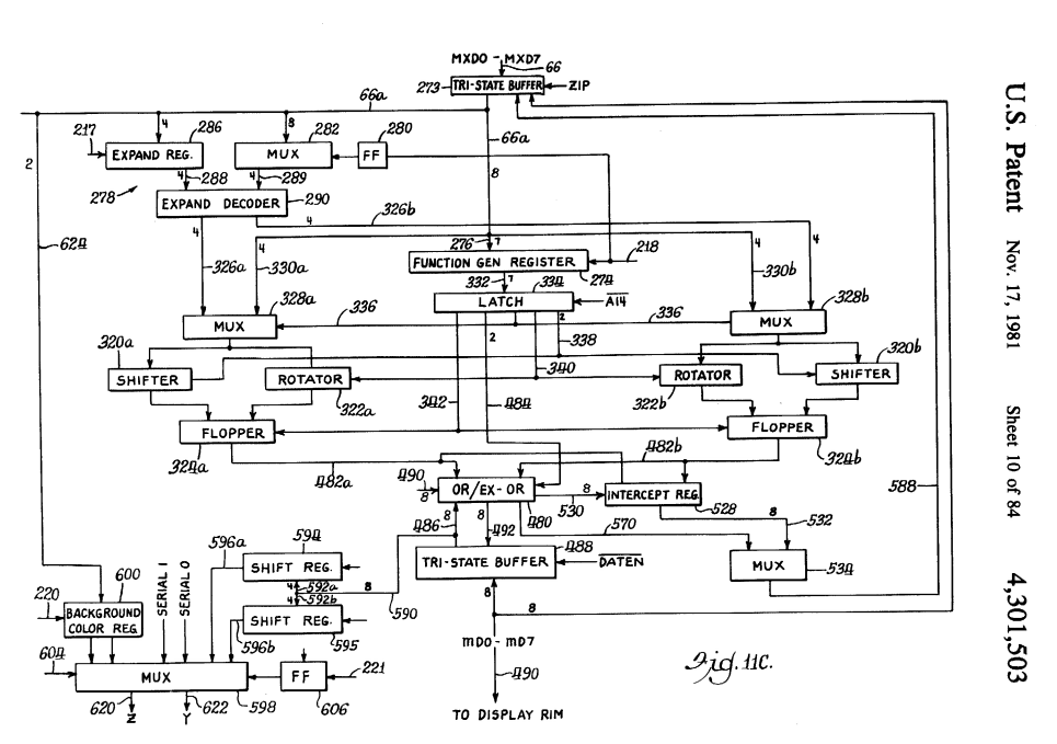

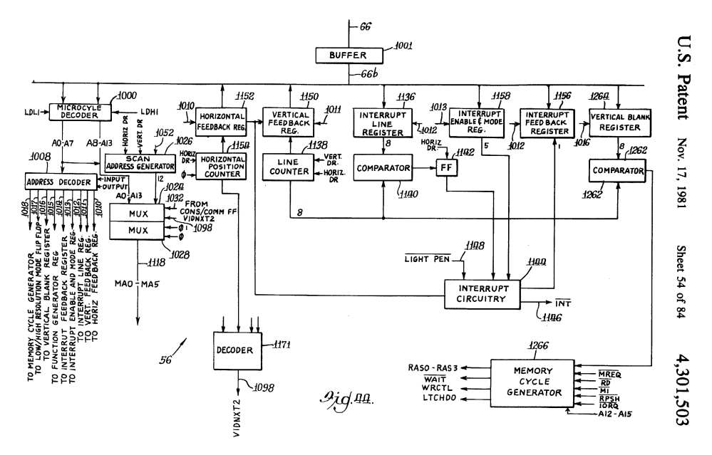

found the patent of the bally game system (237 Pages)
WTF
If you wanna see take a lot time and....
https://www9.zippyshare.com/v/4imBSngi/file.html
Deepest custom Chipinfos ever.
Now I know why no one did this before
interesting, so much technology but no real sprites, Planes, DMA , no fancy soundwaveforms (only 1 bit Audio per channel) but complex anyway.

Nice find!
on the arcade hardware the sprite / blitter function is all done by the pattern board - basically it can copy data from anywhere to anywhere taking 4 cycles per byte (and increment source and destination addresses seperately, and I guess if you blit to the 'Magic' addresses, you can do all the operations that can as you copy the data.
it is used to scroll the screen instructions in gorf - copying the whole screen up 1 line at a time - no scroll registers on this beast!
