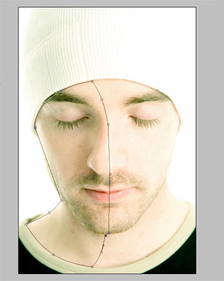

Plot shading area for enhancement with pen tool

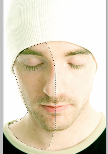

Make selection
Adjustments>Shadow/Highlight

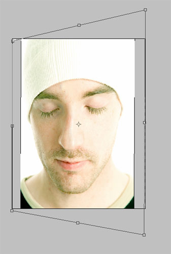

Transform>Perspective
End result

what would be the maximum amount you can turn the perspective before it becomes completely distorted? (i'll try it when it get home).
muddymusic
2,206CR
You can't go far before it looks obviously distorted, but as a quick solution it's ok. The method in the video is a much more realistic way of doing it but obviously a lot more labour intensive.
