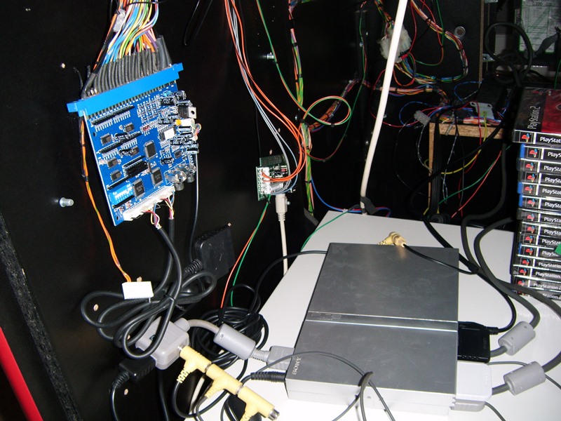

All gun cabinets that I have seen thus far are huge and would require a sledge hammer to squeeze them through my doorways. Needed an alternative then. So I decided to test the set-up in my MK2 cabinet first to see if it would be feasible and I'm pretty pleased with the result. A single gun cab would have limitations on choice of game but this conversion has opened up so much more. All I need to do now is find an appropriate sized cabinet to house it all in. I want to leave the MK2 for JAMMA and MAME.

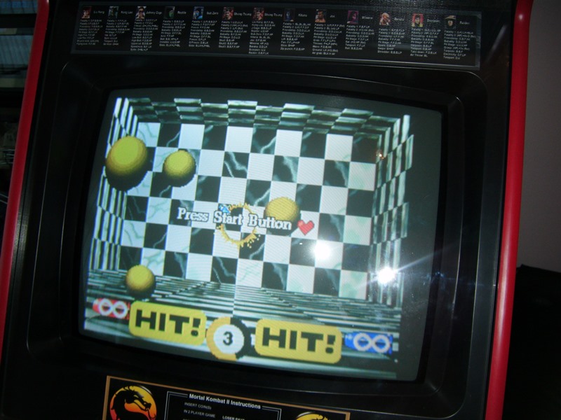

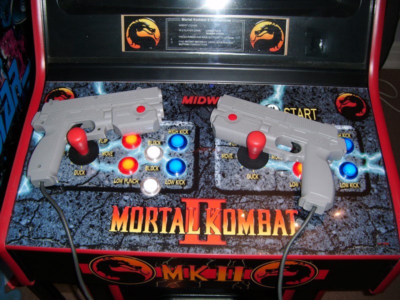

The set-up trial is running a PS2 to JAMMA conversion board with PS2 slim (remote controlled) and G-con 45 and G-con 2 light guns. Plays PS1 games (point blank etc) and naturally PS2 games. The picture is excellent and I really can't tell much difference. Best of all the wife enjoys the shooting games and actually joins in

Thats a lot like the setup I had John Ive got a viletim scart to jamma adaptor and use a ps3 with all the point blanks and time crises, plus a mame set up with aimtrack light guns for the others.
The cab has gone but I have all the gubbins and plan to put it back in a cab someday.
Dont forget to do the guncon foot pedal hack for time crisis

I'm really happy with it, it does everything I wanted it to do and more. I already had everything except the PS2 to JAMMA board, so it's been a very inexpensive way of introducing something new. I've got the move and guns on the PS3. I could do the same but I'm very happy with this. I'm just on the lookout for a cabinet now. Don't know whether to buy something generic or a dedicated standard game that I could do up. Gun cabs are just impossible - dimension size.
