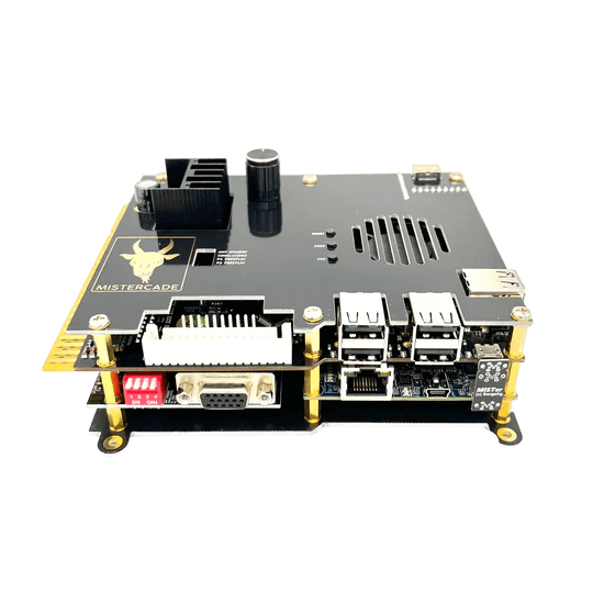

I'll have a look at those and see how I go. Think that might be the way to go, although mistercade looks pretty easy, just pricey
pubjoe
838CR
MiSTercade is popular or there are cheaper alternatives such as the mentioned Aliexpress one or Invzim's (his username here) Jamma-Expander. These options have been around for a few years.
Invzim moved to Malaysia a year ago and is yet to reopen the shop. I have an extra Jamma Exapander that I don't need if you are interested (I bought a quick couple before he closed).
Have a look around for opinions. I have both the above linked kits. The impression I get is that MiSTercade is rich in connectivity and the compact design process was a labour of love. I better understood the price once I received mine.
Whereas the Jamma-Expander is more no-nonsense, simple to setup and has some handy arcade-focused features that can be controlled on the PCB itself with the little switches and OLED screen. User-lock (which blocks UI shortcuts), a switch between keyboard or joystick mapping, and a few UI navigation buttons to avoid plugging a keyboard in when performing updates. It also allows for dual ram.
I personally think MiSTercade has the multipurpose edge if you are going to use the system outside of your cabinet, and Jamma-Expander has the edge if you're going to leave it in. I have no experience with the Aliexpress ones.
The Mistercade2 Arcade that Kingtreelo linked does look very interesting. It integrates the DE10 nano clone with Cyclone FPGA onto a Jamma PCB. It does mean that you're spending on a whole additional Mister system rather than adapting the one you have but at the price that doesn't seem so bad.
