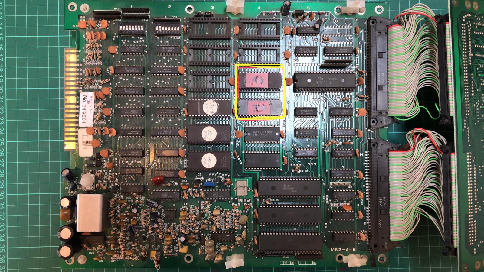

As it's the full set of game ROMs I don't want to publish the full
ROMset here so it will need you to modify game ROMs 4e & 4d using
your favourite hex editor (note they are on the main board next to the
Z80 CPU, not on the top board which are the graphics ROMs) which should
be 27128s.
The changes to 4e are the main freeplay code, the changes to 4d defeat the ROM checksum in test mode.

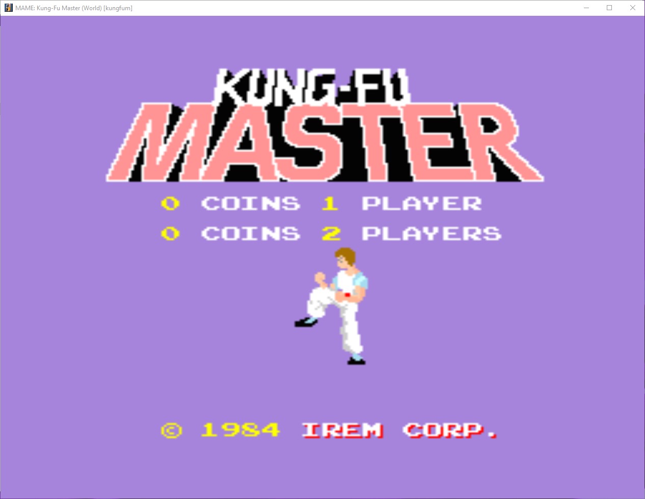

Original freeplay mode (just sat with 2
credits asking you to press P1 or P2 start)
Kung Fu Master cycling through attract mode with the new code
Spartan X
Game board with the ROMs installed
