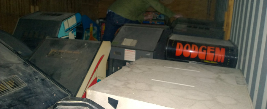

But then one was spotted on the recent Manc raid and fortunately for me no-one else had claimed it, so I said 'yes please!' without hesitation.

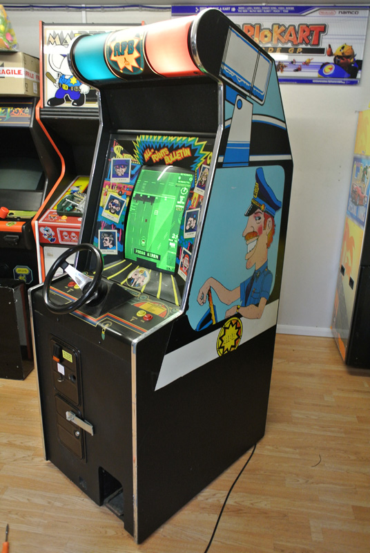

It was very dirty, and of course completely untested and unknown. I could see the monitor and pcb's were inside at least so was worth a punt.
I had a good look over it, disconnected the pcb and plugged it in not hoping for very much.
It didn't disappoint and was absolutely dead.
'Probably just a fuse' so the popular eBay phrase goes....well it turns out it was the next best thing!
A quick wiggle of the monitor power lead, check of the voltages and I gave it a full test...

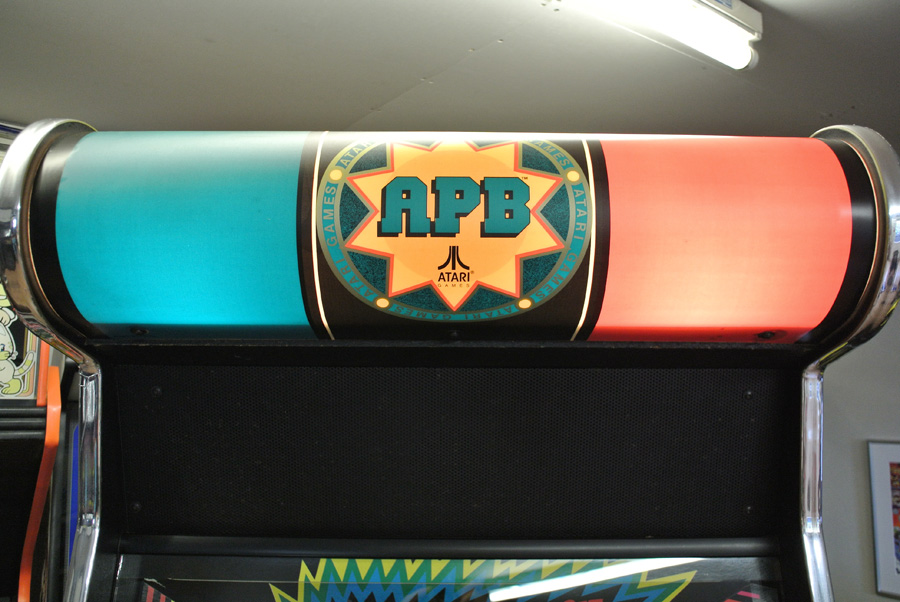

Result! Couldn't believe it, fully working. No marquee lights though, and the flashing lights on these almost never work, but another wiggle in the back of the marquee power wiring and they were working too!

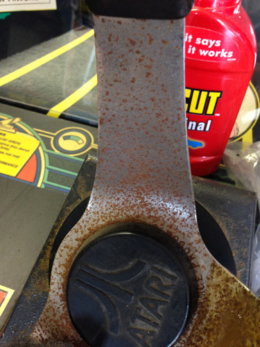

Decided I couldn't stop there so gave it a proper clean up so I could put it in my row of cabs. Some of it was pretty rusty like this wheel, and there was a lot of bird poop etc. covering it.

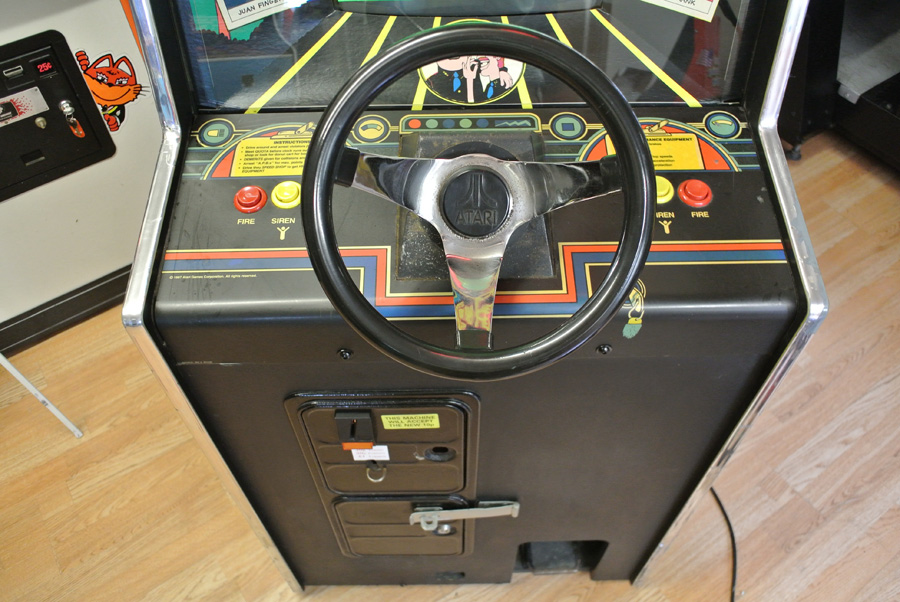

After a good session with Henry, T-Cut, Novus, Windowlene, Mr. Sheen and Magic Erasers it came up pretty well

Wow, what a result.
What products/processes did you use on the steering wheel. The result looks amazing.

The T-cut was used to clean up the wheel. You use some fine furniture grade wire wool with it and gently rub over the rusty areas and it will remove all of the surface stuff.
Clean it off with a clean rag, then buff with a tiny bit more t-cut and it comes up nicely as you can see.
