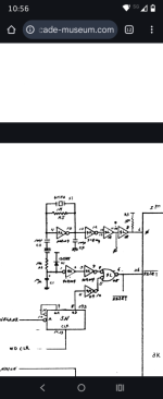

Pity there's no schem, but I read that the Bomb Jack one is similar. I've been trying to decipher it. It does seem to show a tc40h00p being used in the same way.
Is there a cheaper alternative to a tc40h00p that I can buy if I need to replace it? They seem quite expensive.
Lurch666
21 (100%)
4,482CR
On the bombjack schematics it's actually a TC40H004. Is that the chip on your PCB? Maybe the markings are hard to see?
Anyway the TC40H004 is a set of six inverters. You need to see if there's an output on any pins that have a signal on the input.
I.E. If there's a signal on pin 1 there should be an inverted signal output on pin 2.

Ok, I couldn't get any sensible readings on the TC40H004P so I pulled it, fitted a socket, and replaced it with a CD4069UBE, which looked like a good, cheaper alternative. At about £15-20 a pop (with shipping) for a TC40H004P, I don't want to start throwing money at this board until I get some sign of life, as I'm starting to think I've bought a complete lemon. Lol
Anyway, I now have a working clock, but the CPU is still constantly resetting. I've managed to trace the pulsing signal on the CPU reset pin back through a couple of other ICs to pin 6 of a 74LS393 at 6E. This is apparently a dual 4-bit counter (which is what's shown as 5N on the schem above, I think), so I have a bit more reading up to do before chasing things any further.
