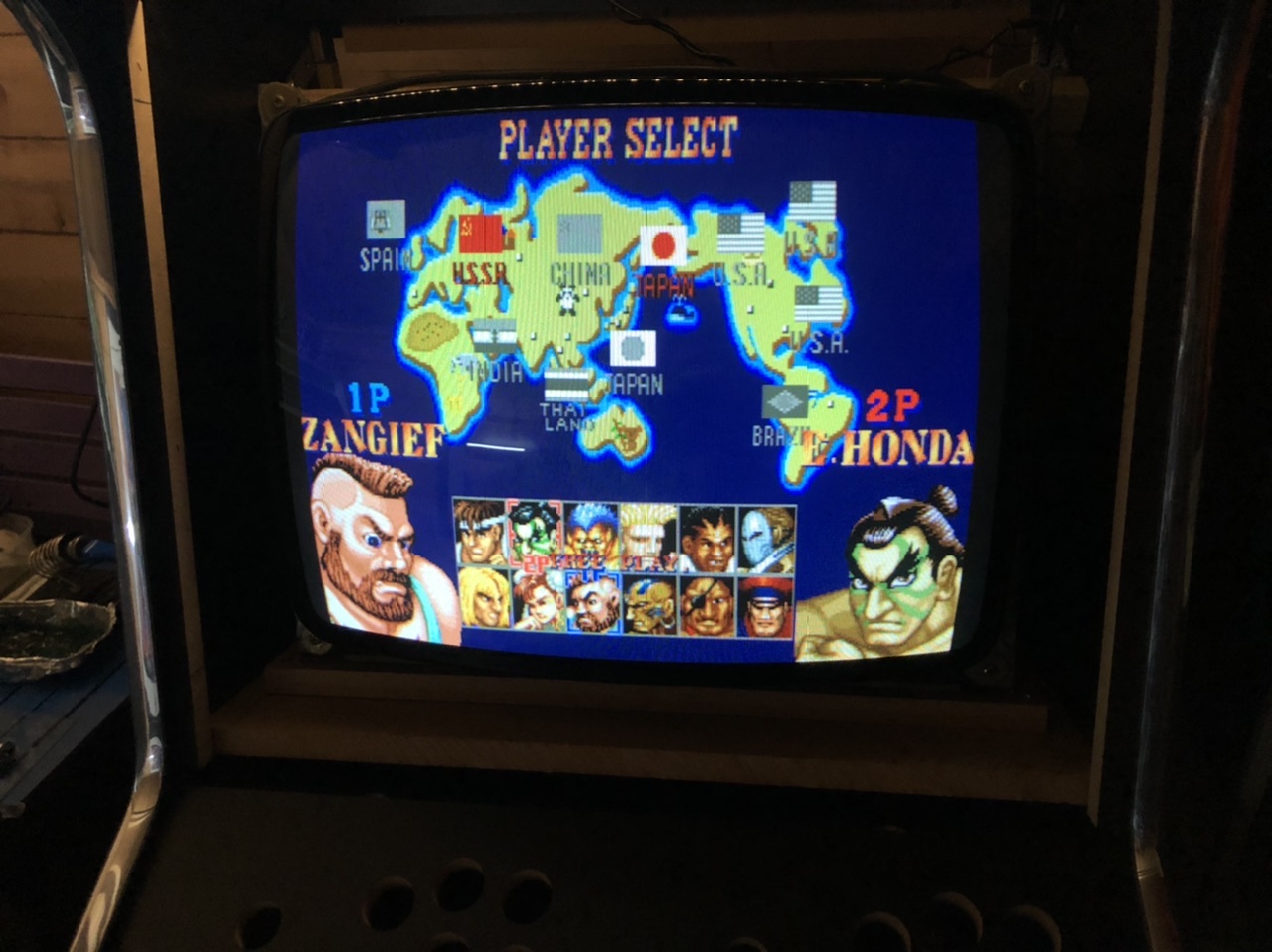

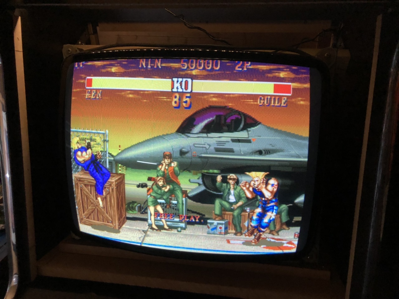

Really nice monitor but can’t get any more width than this, tried hoz pots but doesn’t want to move any more. Any suggestions would be welcome thanks.

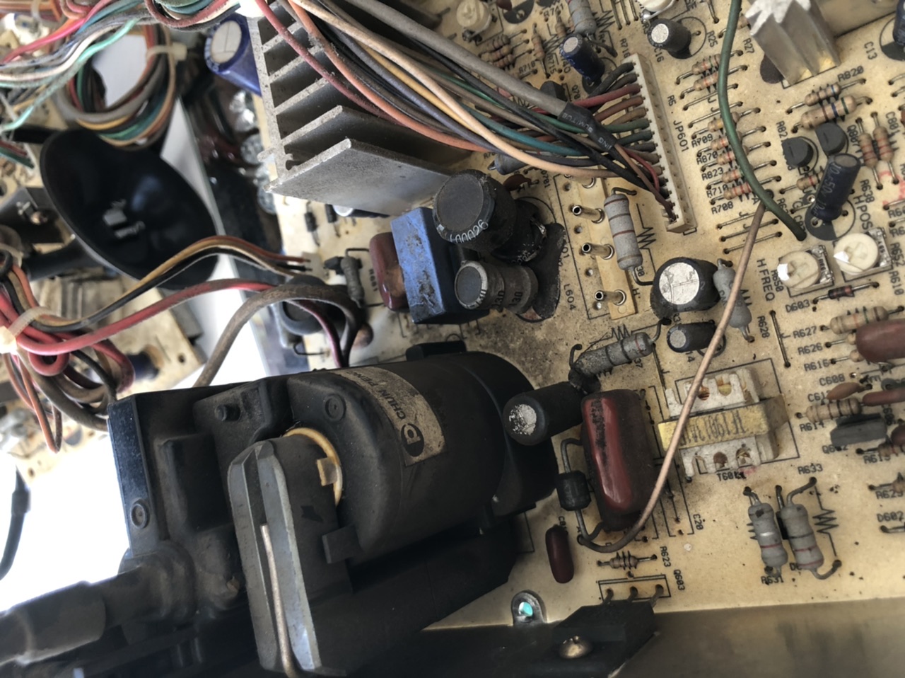

Sometimes there is a horizontal width coil that can be used to adjust the width, usually looks like wire coiled around a plastic tube, sometimes has a knob to turn other times you need a plastic adjustment tool to stick it to turn.

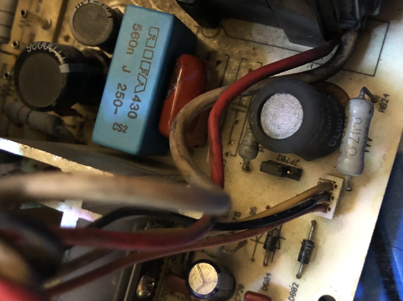

if the horizontal width coil doesn't cut it, there is also a cap in this circuit which you can replace with a higher or lower value to change the width. It's usually a chicklet cap near the coil.

Cheers guys the monitor is a tatung type 58 vga monitor vt-2040B, the width coil looks like a cap and haven’t changed it and there is no way in adjusting it, I’ve played about with the different horizontal pots the frequency, phase and width pot doesn’t change anything. I changed the width cap by the flyback from a 680nf 250v to a 560nf 250v cap and it made it a tad wider but a matter of mm.

Like iamjimi said width coil.. it is the copper coil on chassi
Width coil but you want the plastic tv adjustment tool
As there is a fragile core inside the copper coil that a metal screw driver will break it.
If I remember right it is a flat type slotty I when attempting to turn it slowly and carefully.
Also and first try the width pot on chassi as width coil “should” be factory set in middle

EDIT: Is this the same chassis as yours? I think the red arrow Ive added to this picture is the horizontal width coil if its on your board. Its a bit hard to tell with the zoomed in pictures you have posted instead of a full one of the chassis.
