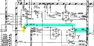

Do you have a Logic Probe? Is the Watchdog counter getting nVBLANK?
I think you had a stable picture so most of the video circuitry should be OK.
If your board is like a Galaxian then...
You want to know what is going on at pins 1,2 and 6 of the 74393
It's just a counter... causes a reset (on pin 6) if it doesn't see a CLR (on pin2) before too many nVBLANKs on pin 1.

All the signals around the 393 look good and clean, I’ll try disabling watchdog.The boards are very similar to Galaxian so I can make comparison.

74393 is never reset(pin2=lo).working back WDR is inactive, and the signals it comes from look ok. I notice the board behaves the same if the 5 256x1 SRAMs are removed. I don’t have replacements.

So probably the CPU isn't coping well due to system ROM and/or System RAM... but you can follow it back a bit further.
You can see that the WDR line is controlled by a READ to an address... 0111 1xxx xxxx xxxx i.e. a read to $7800 would do it.
You can also see if Interrupts are being serviced...
Looking at 6F should be informative... you should see pulses at pin 9 and pin 10. pin 10 is the "I'm done with this interrupt let me know on next VBLANK signal" and pin 9 is the "We've had a VBLANK and were enabled... let's go again signal"
Ignoring graphics... the CPU really only cares about the ROM and system RAM... that's the ROMs and the RAM and 7N and 7P.
Let me know if you already know this... and I will leave you to it.

Thanks for all the info, I didn’t know all this infact I don’t know much about this circuit yet still learning the operation.
A13 is inactive so no WDR.

Ha ! Found it thanks to your pointer. PCB tracking error, the NMION signal was tracked to the wrong output pin on a 259. Linked it to the pin as per the circuit and my board is alive.
I had changed that chip and removed the solder bridge that it needed without noticing it was present. To compound matters the other board I purchased had the same issue ! Thanks Nivag I could have spent another week looking for that 👍
