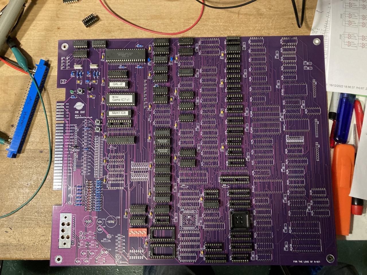

A progress pic of assembly so far :) This all the sockets and parts needed (hopefully) for the clock, video count, main cpu and memory addressing, video output and foreground graphics(text) sections. Still need to populate all the sockets you see empty. Will be giving it a go soon and see what we get. I'll be using the built in memory tests to to check each graphics section once i get this part functional.

Now we are back and running on the new Ukvac, I can update on recent progress with the mr do clone!!
Originally I was trying to assemble different sections of the video section to test independently ie bgnd foreground, sprites etc but I just wasn't getting any stable picture. So I decided to assemble some other parts as well. Here is the progress
This got me to this stable screen.
Game doesn't run yet , but to see some decent clear video output was a good milestone and also proves a lot of design sections. Next to work out why the game code doesn't run.
I also populated the reset of the sprite section to see what the garbage screens looked like to compare with an original board etc.
This is what I get now on first power on. Not the same yet but is encouraging.
More to come :)
