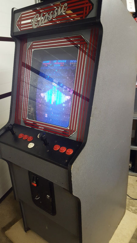

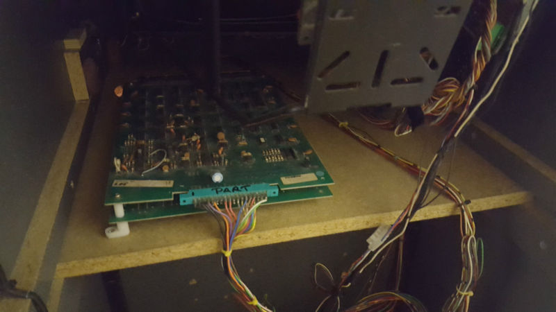

Well no longer chappets, I am the proud owner of my first cab with an original Phoenix PCB.
It was on ebay, not in pristine condition I know but this only cost me £150 all in, I can do some magic, learn the trade lol, make some additions of a multigame board. sideart and so on.
Here is part of the original advert.

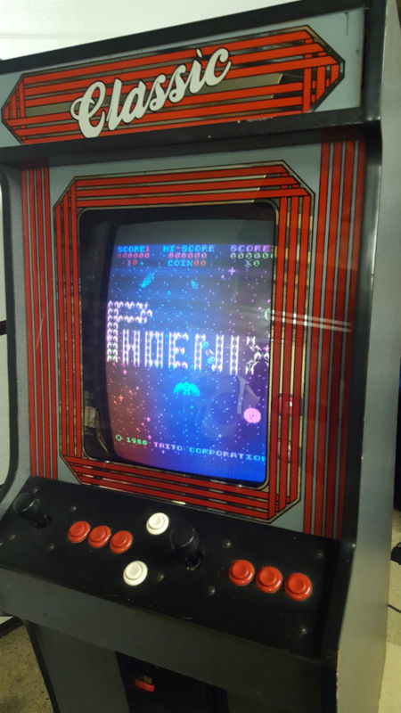

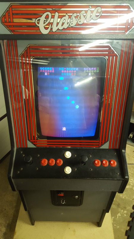

"It has a genuine Pheonix board and was working until recently as it took longer for the screen to boot up. It now sometimes works and sometimes does not. The colours have gone funny as you can see in the pictures. The sound has never worked and dont know why."
Any ideas chaps?

Looks like degauss issue to me. The lads on here can tell more about that if they agree (something about a black wire that goes around the monitor). Waving a large magnet thing around has fixed this for me in the past!

Defo looks like the monitor needs degaussing. Monitors in JAMMA cabs are usually set to auto degauss every time they're switched on, but have a look around for a button to do it. If there's no button, then the degauss circuit is probably faulty, but is usually a simple fix (if you're prepared to remove the chassis to work on it).

If the degaussing circuit doesn't work, either fix it, get it fixed or just leave it alone and manually degauss it with a degaussing wand.
