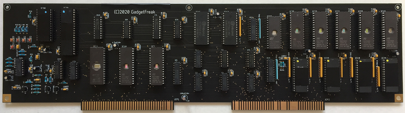

Had to wait weeks for these boards to get here! Thankfully they worked first time with no patch wires
GadgetFreak
952CR
That didn't take long
Yes, having already devised a plugin board set which worked perfectly, I wasn't happy. So took on the challenge of making a full replacement cartridge and am happy to report it works perfectly.
At the moment it still requires the main board bios roms to be patched so I am now working out if I can instead implement the menu on the cartridge to make it even simpler to install.

It really is the culmination of months of work that I started back in 2016 when I first de-slapped the games.
The multiple plug in board version works the same and is the only option for a cockpit board set but on the early carts it won't play all the games as the raster interrupt hardware circuit is not there.
Hopefully the menu code revision I want to do won't take long, then I will be making these available for sale
I have also finally sorted out a proper Gauntlet Multi with an onscreen menu and 2 & 4 player versions of both Gauntlet I & II. It is 6 plugin boards linked by a single wire and requires no physical board changes. A forum member does have a set of boards, I am just waiting to see how he gets on with it before putting it up for sale.

I did, but he had a problem in that he couldn't jump back to the menu from demo mode. So I had another user install it which highlighted a different issue that I have now fixed. I can only presume the first issue is a minor fault on the installed board. So it's just about ready to go.
