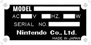

Todays news is that I have the artwork for the metal serial plate finished and a company to output them on stainless steel with holes cut and the black over printed.
Ill be stamping the serials and other data with some punches. I have to order a quantity so if anyone wants any let me know. I can stamp them up with whatever info you want when they are ready. Ill have to figure out a price though.
