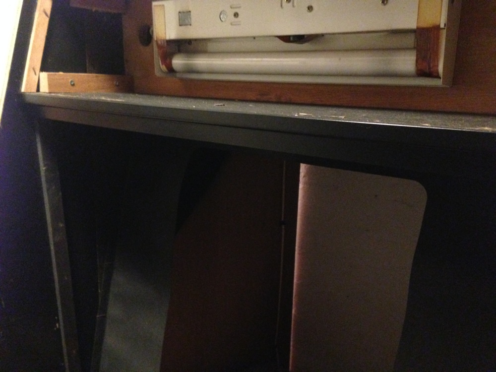

Had another look at the monitor and casing. The chassis boards all look ok, no bad burn outs, or damaged pcs as far as i can see. They are dirty and the metal chassis frame needs replating. The monitor tube itself has a label of 510UKB22, which appears to be a Mitsubishi tube. I noticed for sale thread on here a month or so ago for one of these, so maybe there's a chance to swap the tubes over if i can find another :)

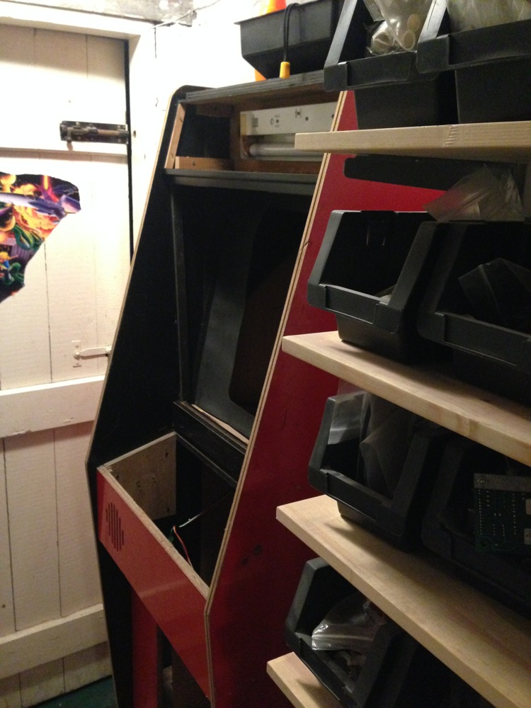

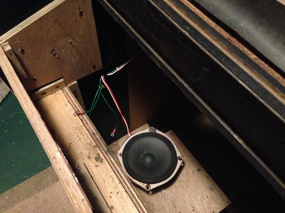

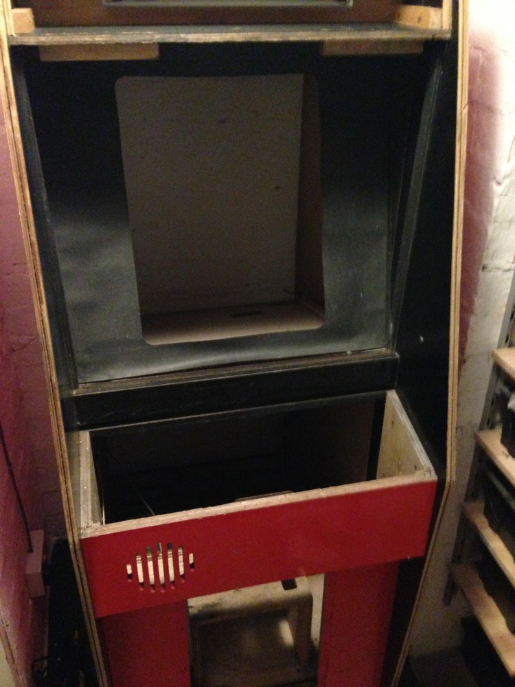

This is how the inside front is looking after some cleaning of internals, wiring etc. Also hopefully shows the condition of the plywood is all sound to :)

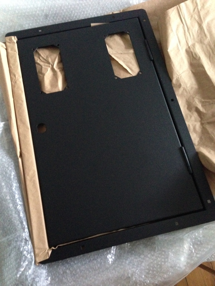

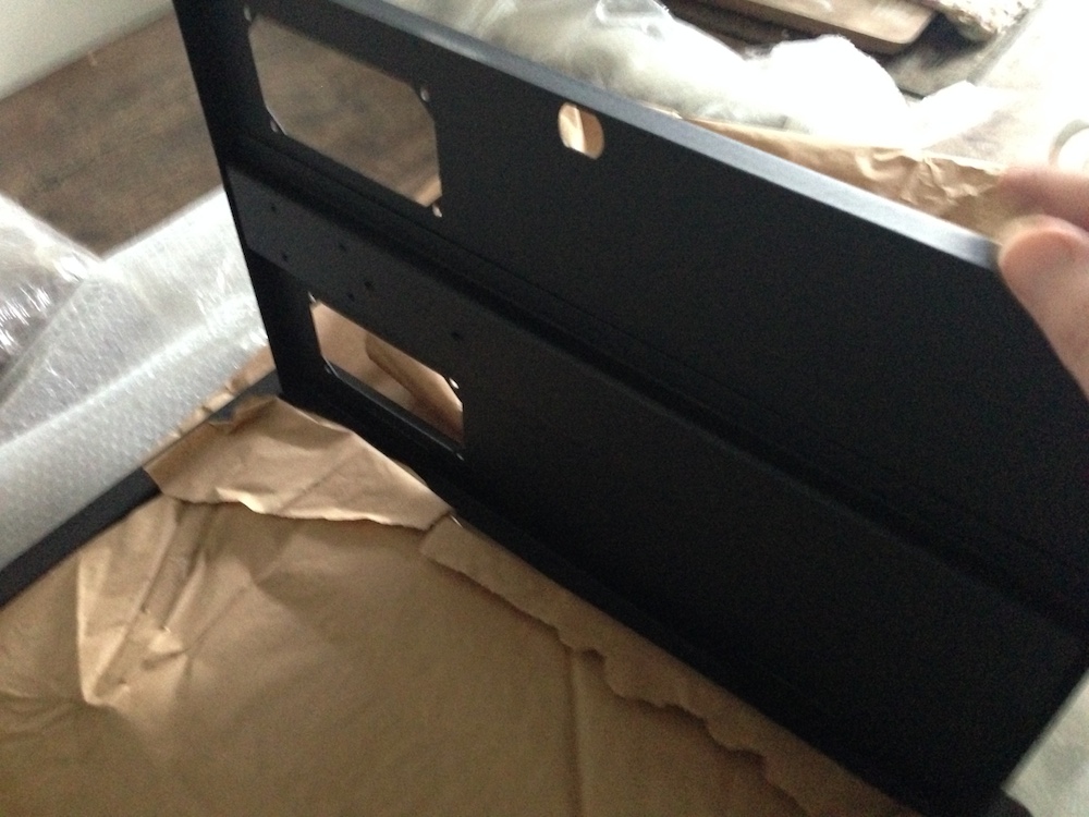

Another question for chuckie egg and muddymusic (and any other nintendo experts). Whilst i was stripping down the coin door & frame i came across a bit of a problem trying to remove 2 of the bolts holding the door in place. It seems that part of the cabinet wood frame that supports the outer cash box casing cuts across these 2 bolts making it almost impossible to remove them without cutting them. Is there some magic way to get these out, or are there differences in cabinets? I think it was the 2 bolts at the bottom of each long side that were obscured.

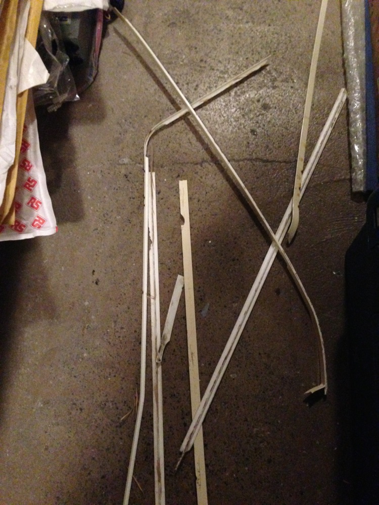

T- moulding removed and cab edges cleaned. The old stuff was really stiff and brittle and very yellowed. Waiting for new to arrive. Can't wait to get this installed :)

Jim regarding your bolts
These earlier Nintendo.co.LTd cabs are different to the later Nintendo of America cabs so I will check my sheriff and dk tonight.
I do remember when I put my newly powder coated door on sheriff it being difficult but i managed to get all the bolts in.
And like Rog said Try and get flat T moulding if you can

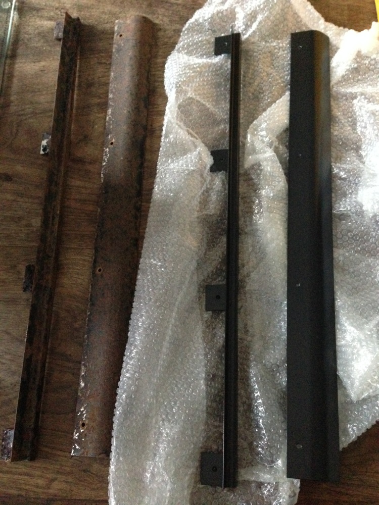

Some more pics of progress. I finally managed to get the lower monitor support bracket out. One of the bolts on the rhs was rusted solid, so had to drill the bolt top out.
And i have fitted my first new piece of metal work. The lower marquee/upper bezel support.
