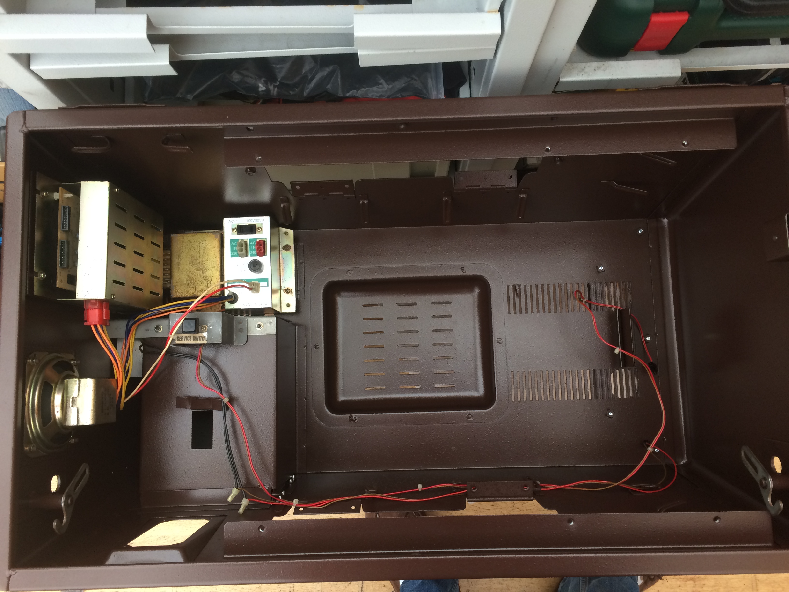

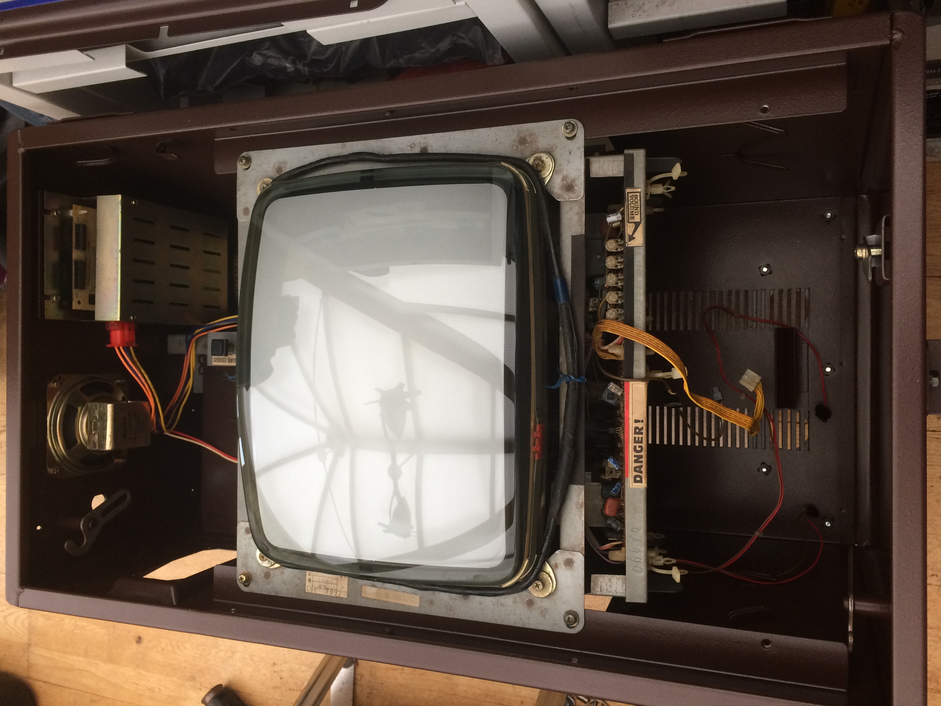

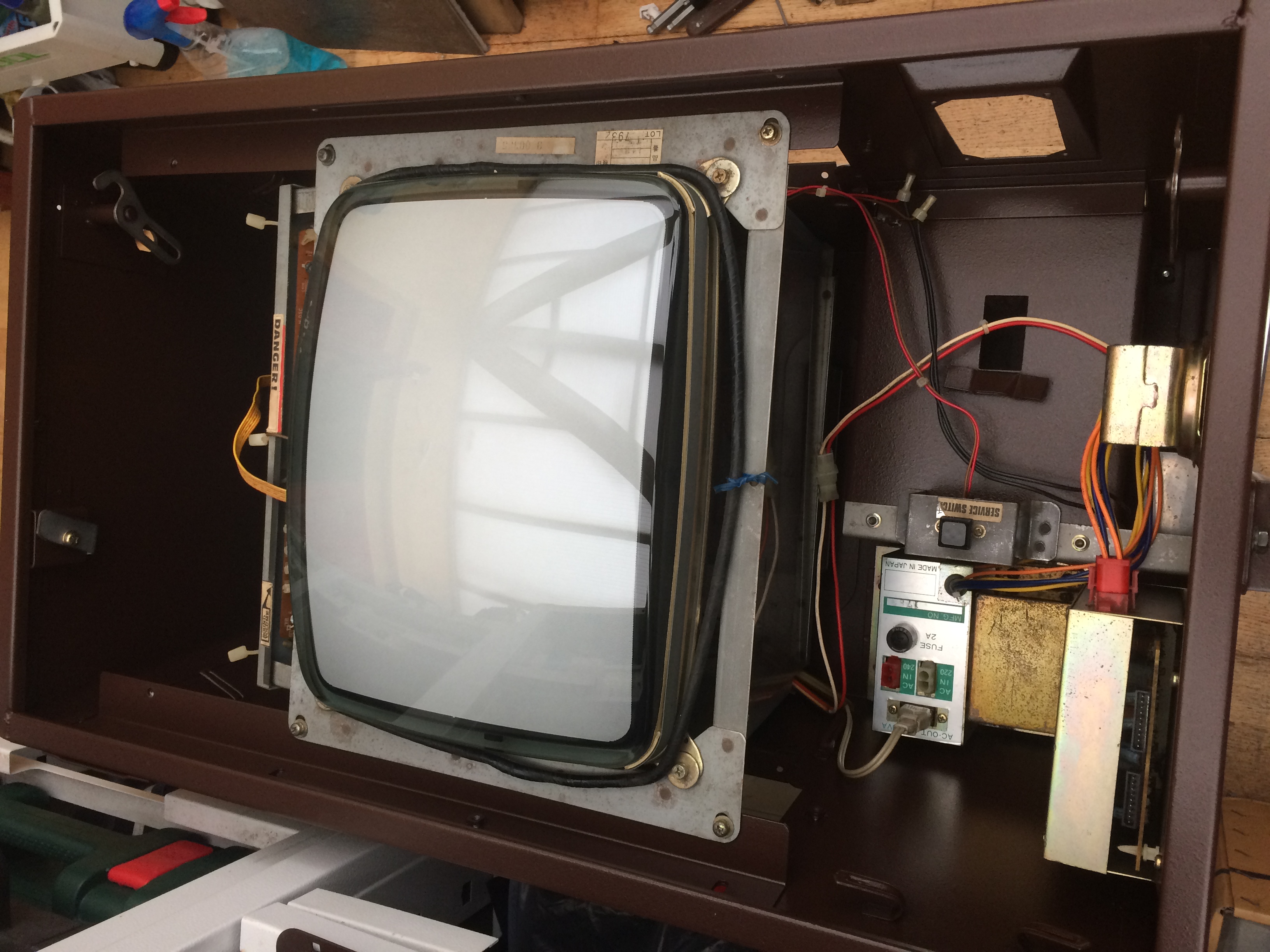

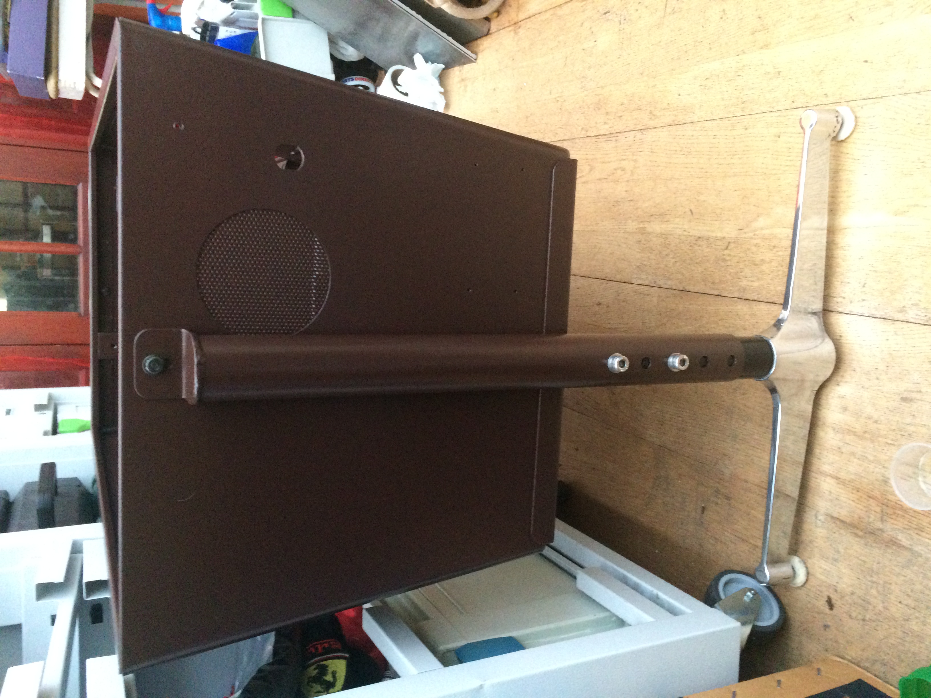

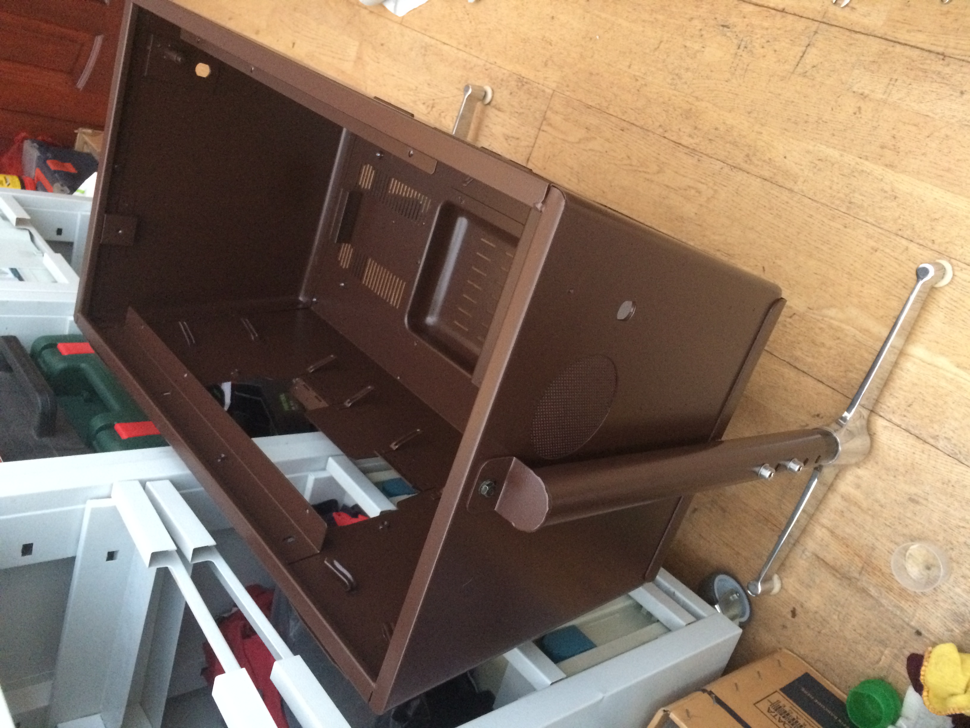

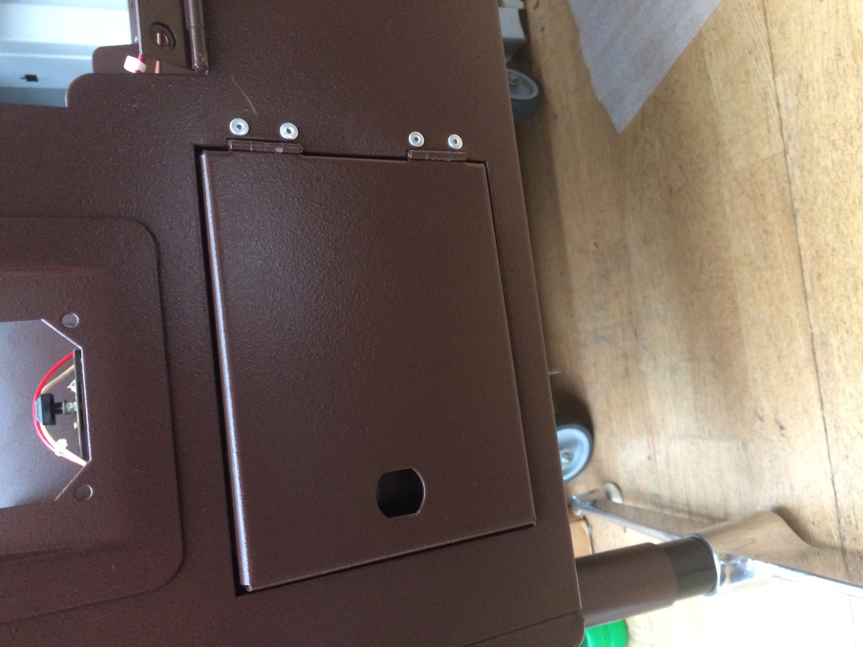

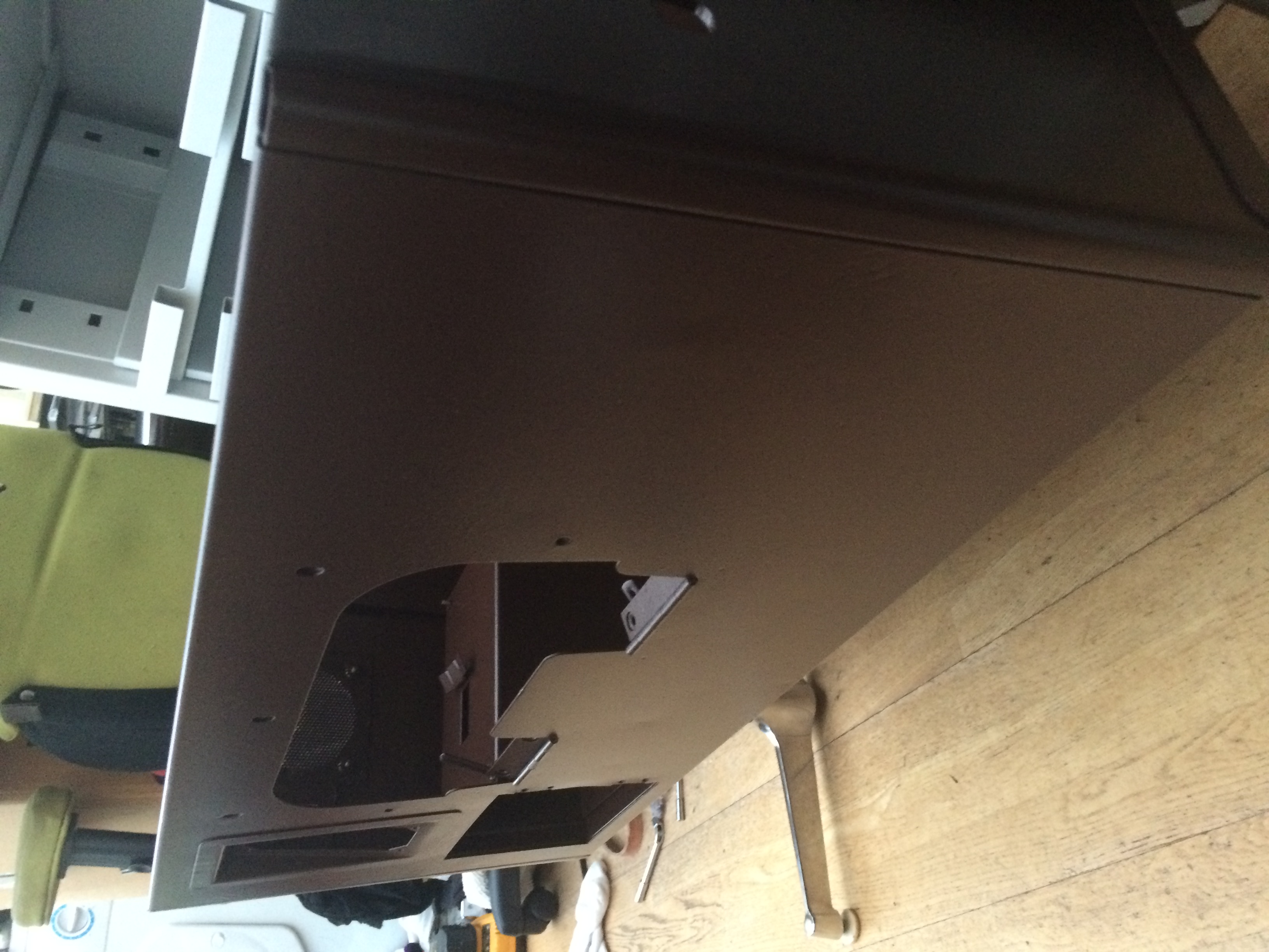

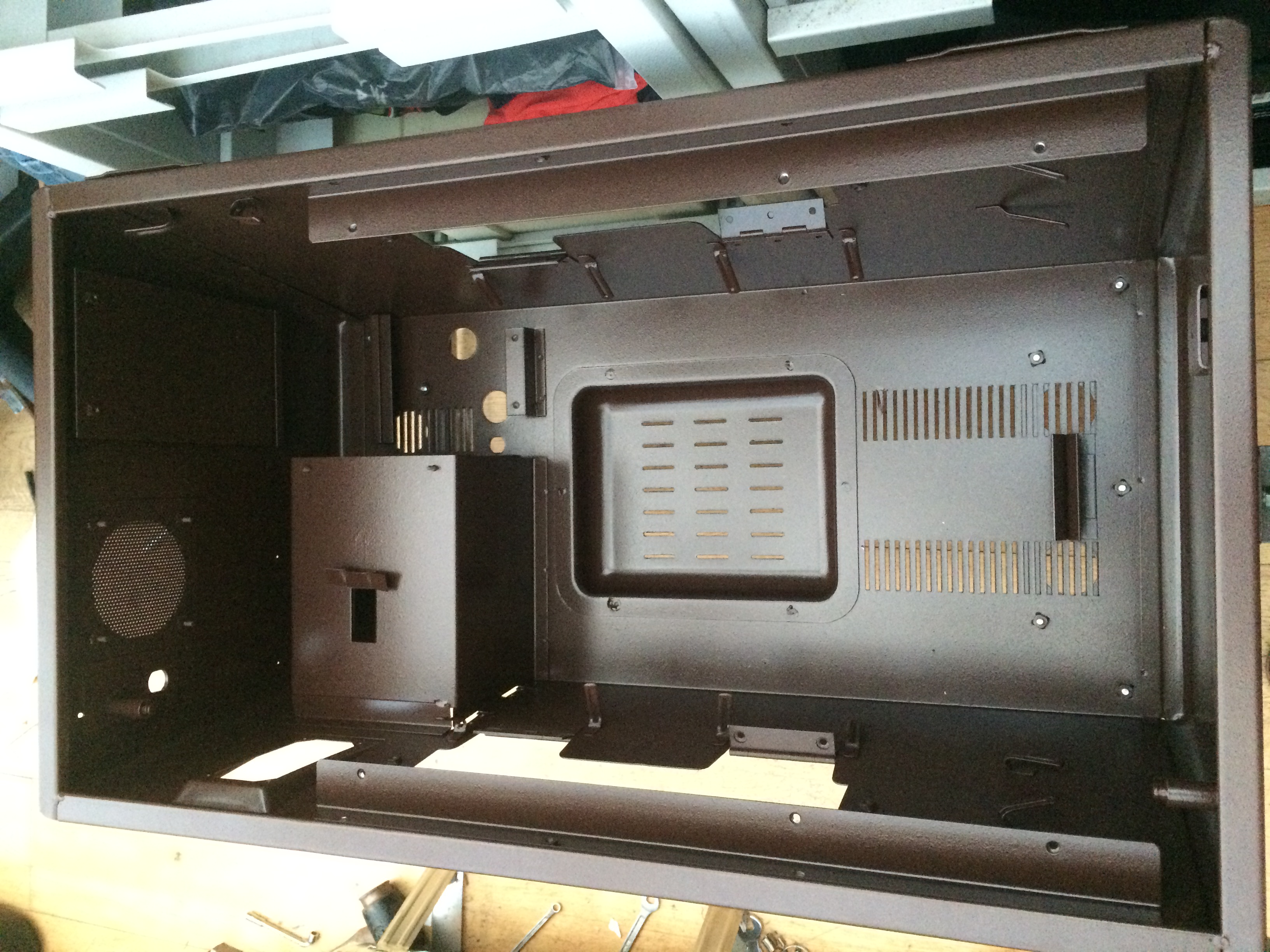

Well I’ve well and truly started on the total restoration of my space firebird!!!
Jobs done so far cabinet totally stripped and sent to the paint shop and returned in fresh new paint !
Copied to the closest colour to original as I could find and decided to replicate the finish !
I’m sure you would agree it’s not bad! Re-tap all the holes just in case any paint got in there!
Bottom legs polished nice and shiny!!!
More to follow if I get a chance at the weekend !!

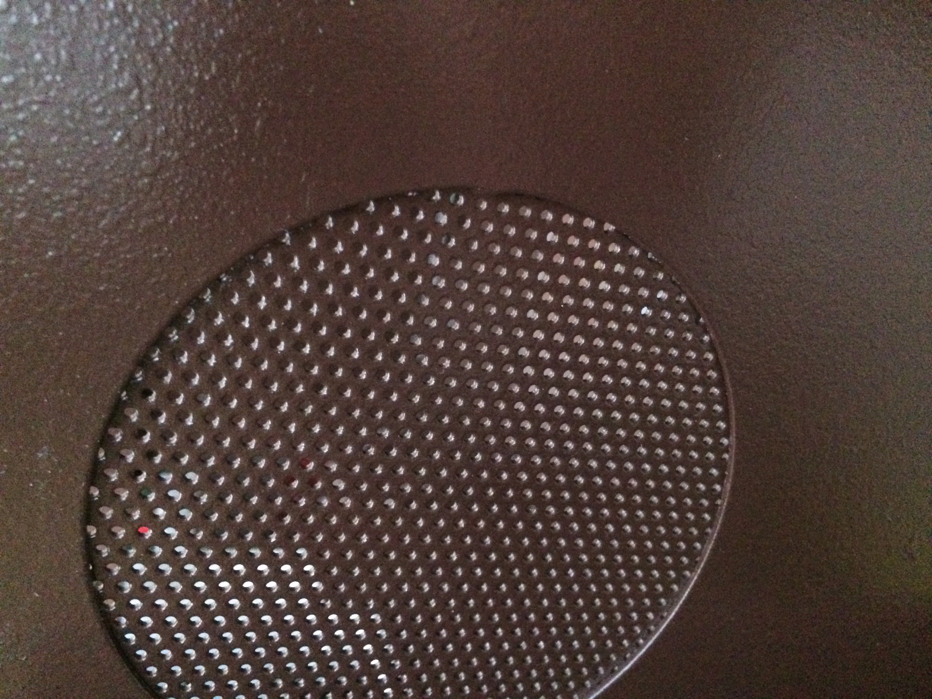

I don’t know how far away you guys are but this was done at a company called luster coatings in Tasburgh Norwich!
They were extremely helpful to get exactly what I wanted! I could have had it powder coated but not to Match the original colour so was blasted undercoat then wet spray! Probably not as durable as powder coat but thought I’d try something different!

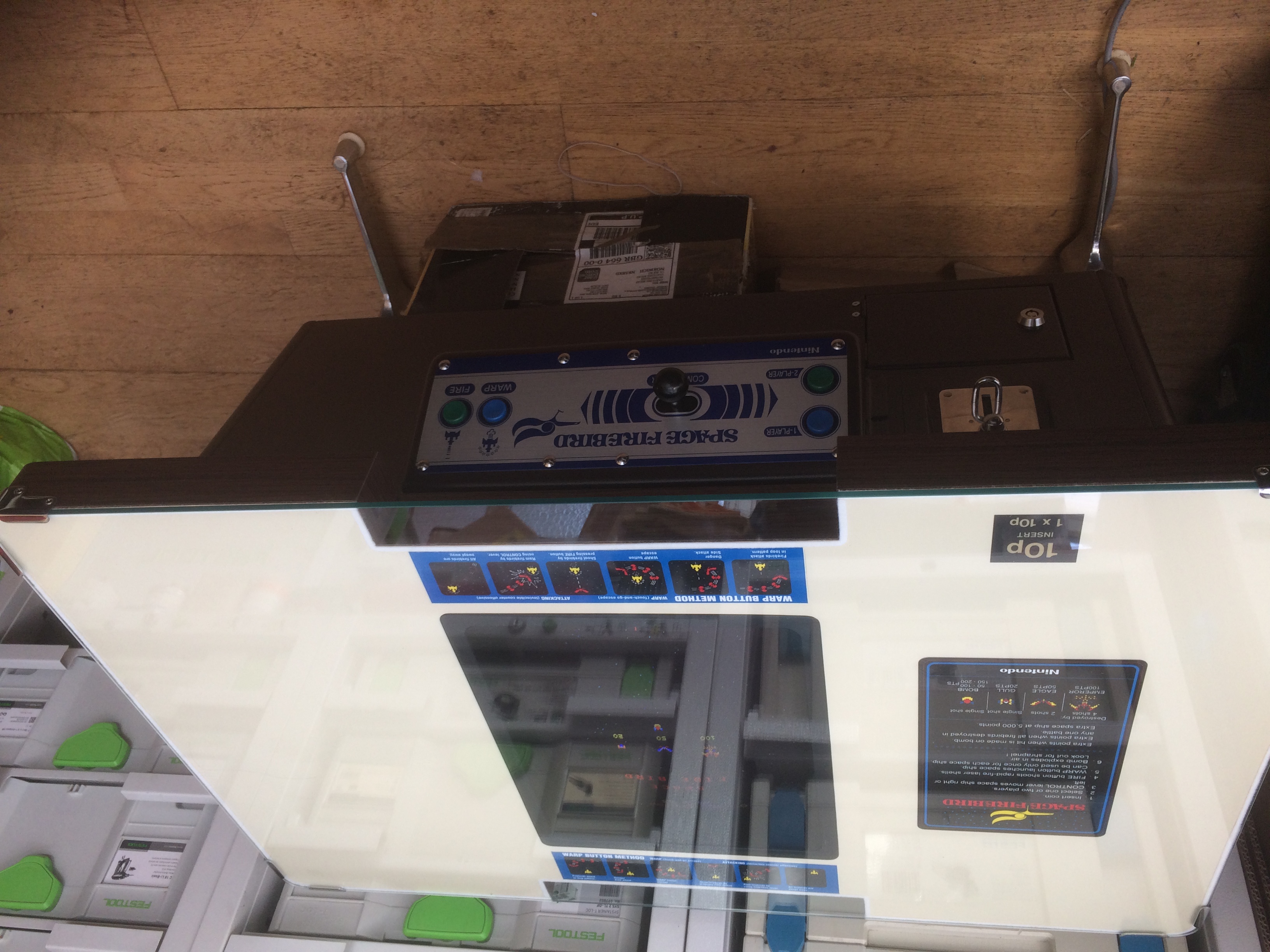

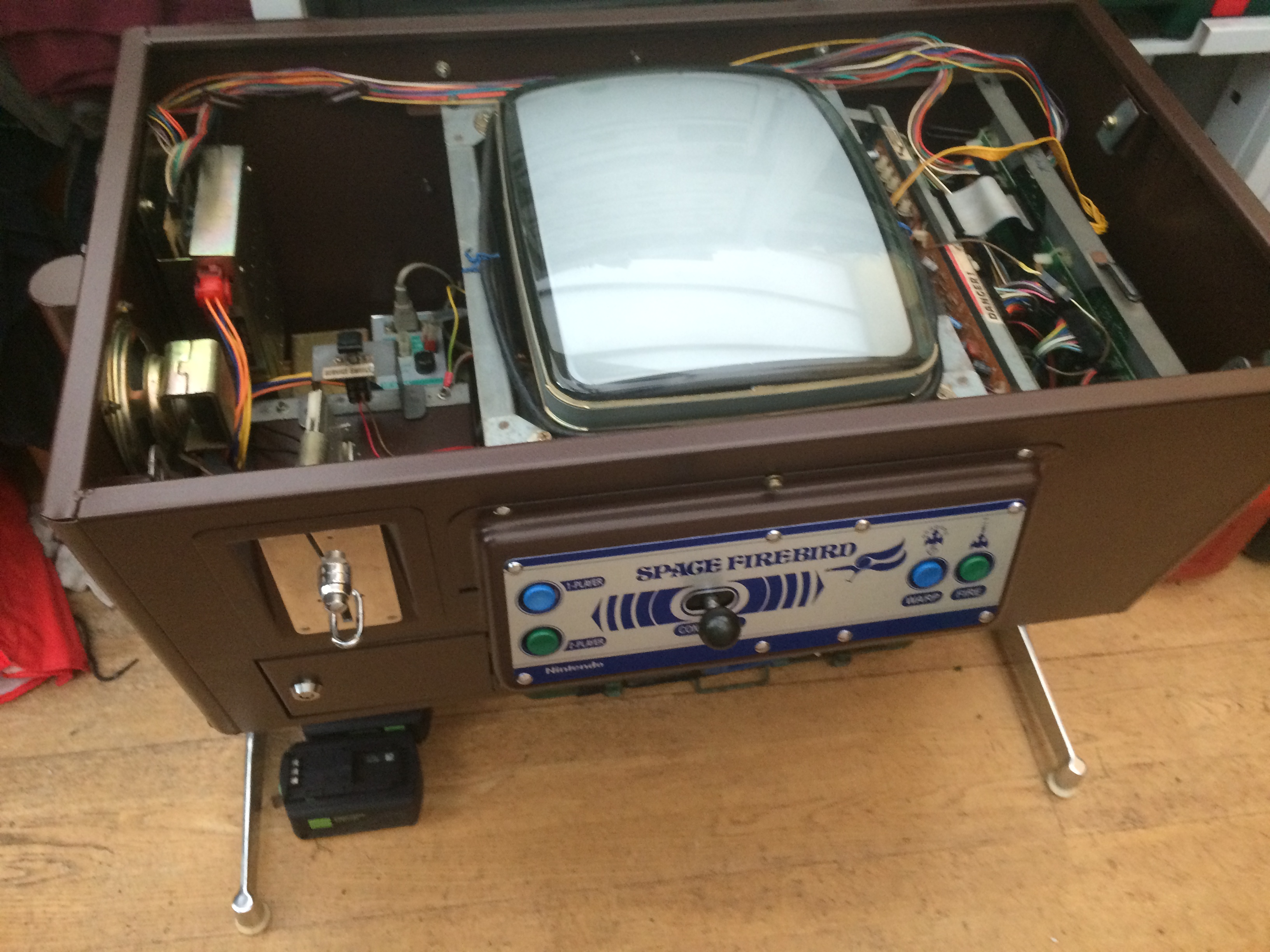

Quick update!
Rain stopped play for doing the garden SHAME lol

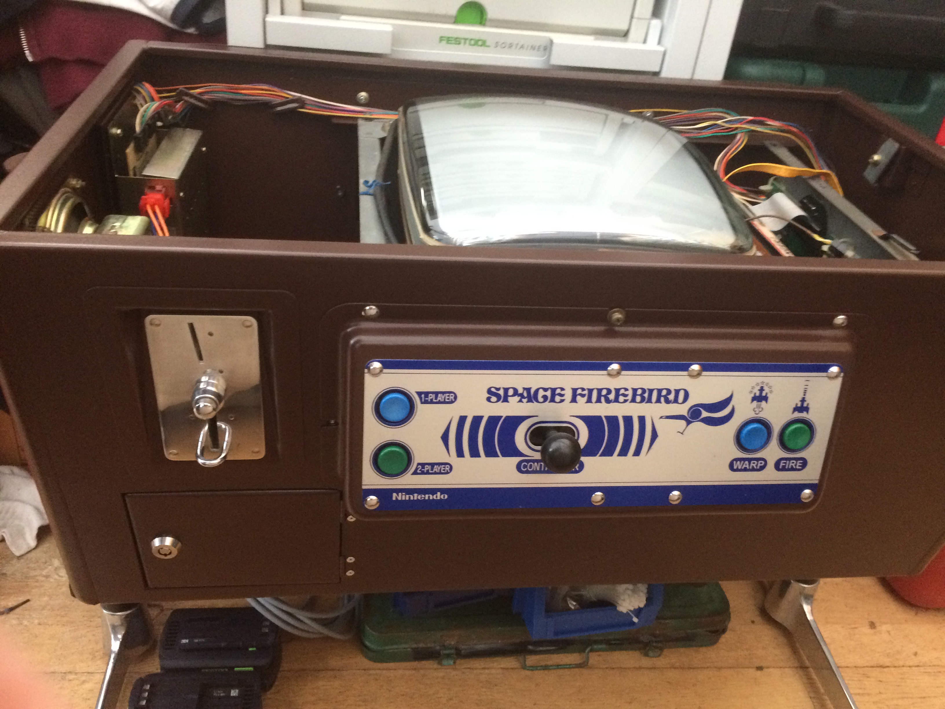

So managed to do a little more to the table!!
Just got the Control Panels to rebuild as a bit sloppy!
Then the table top to get the treatment!

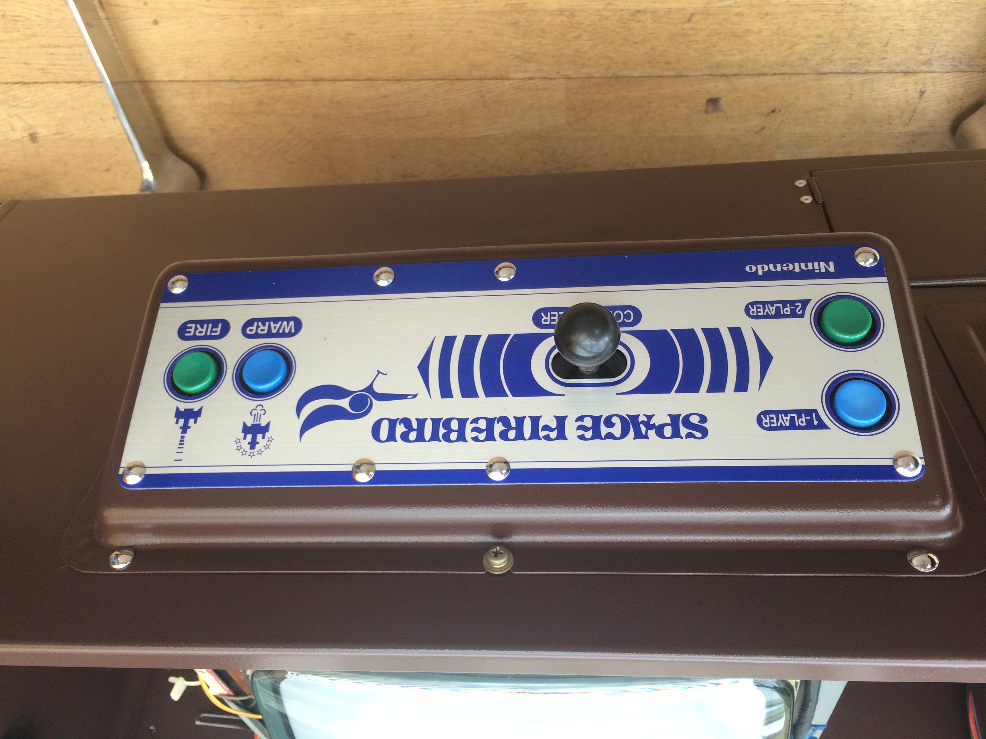

Cooking on gas now!!
Control panels serviced and fitted just got the coin mech and correct locks (Takigen K6510) to fit

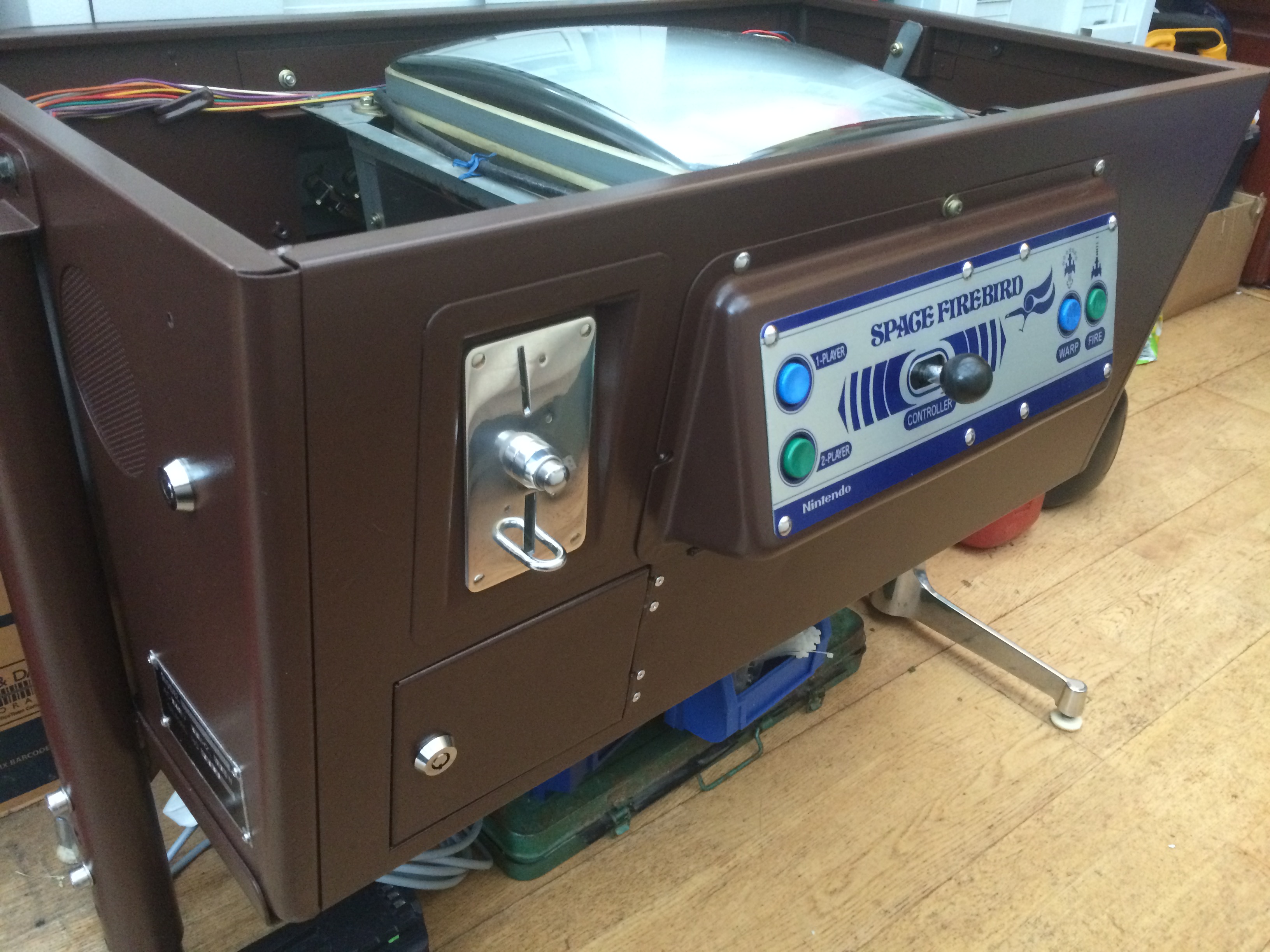

Got a little bit further!!
Coin receptacle fitted & new Takigen locks all fitted!!!
Just the top to complete!!!
Can’t wait to get it completed!!

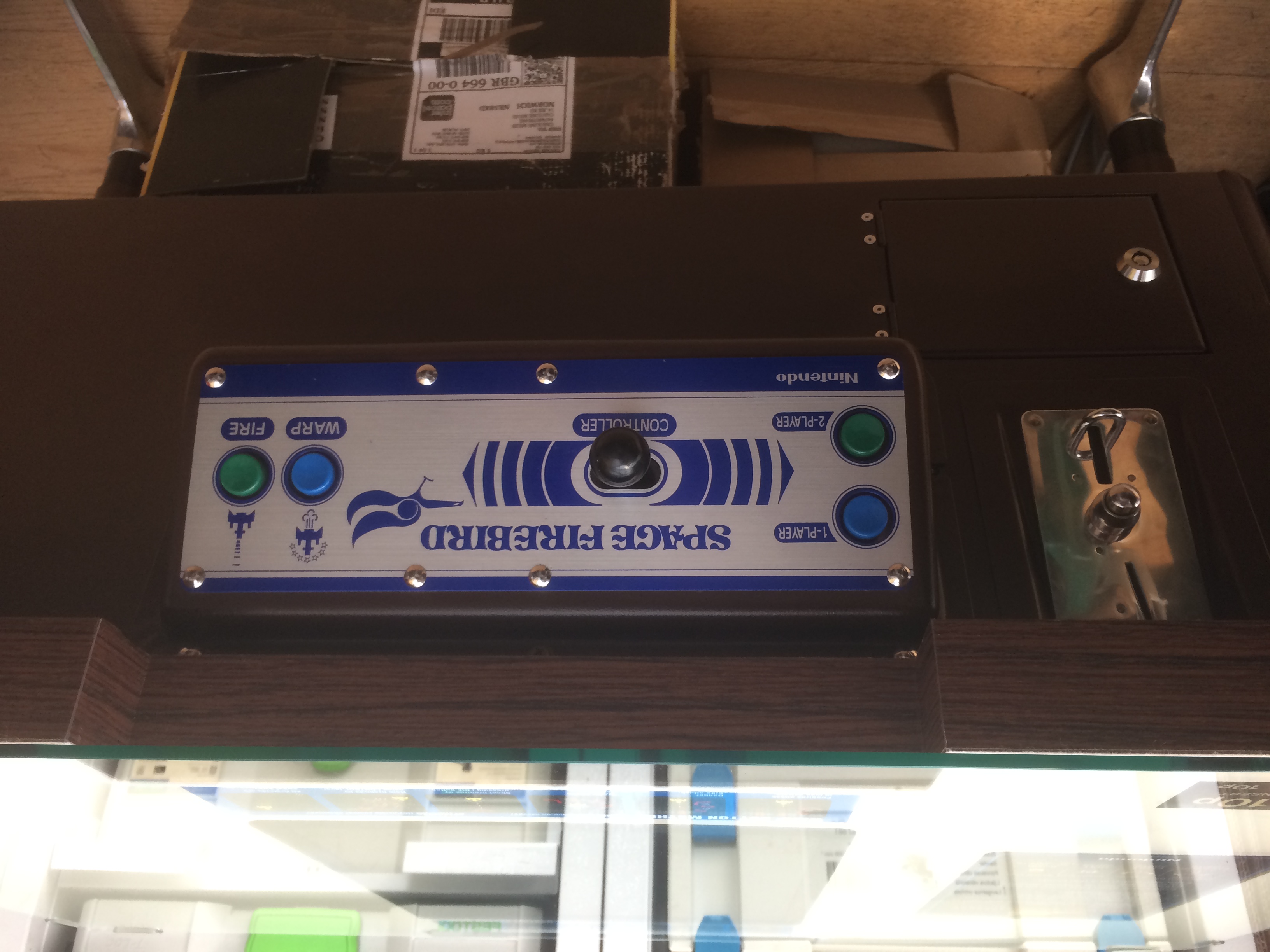

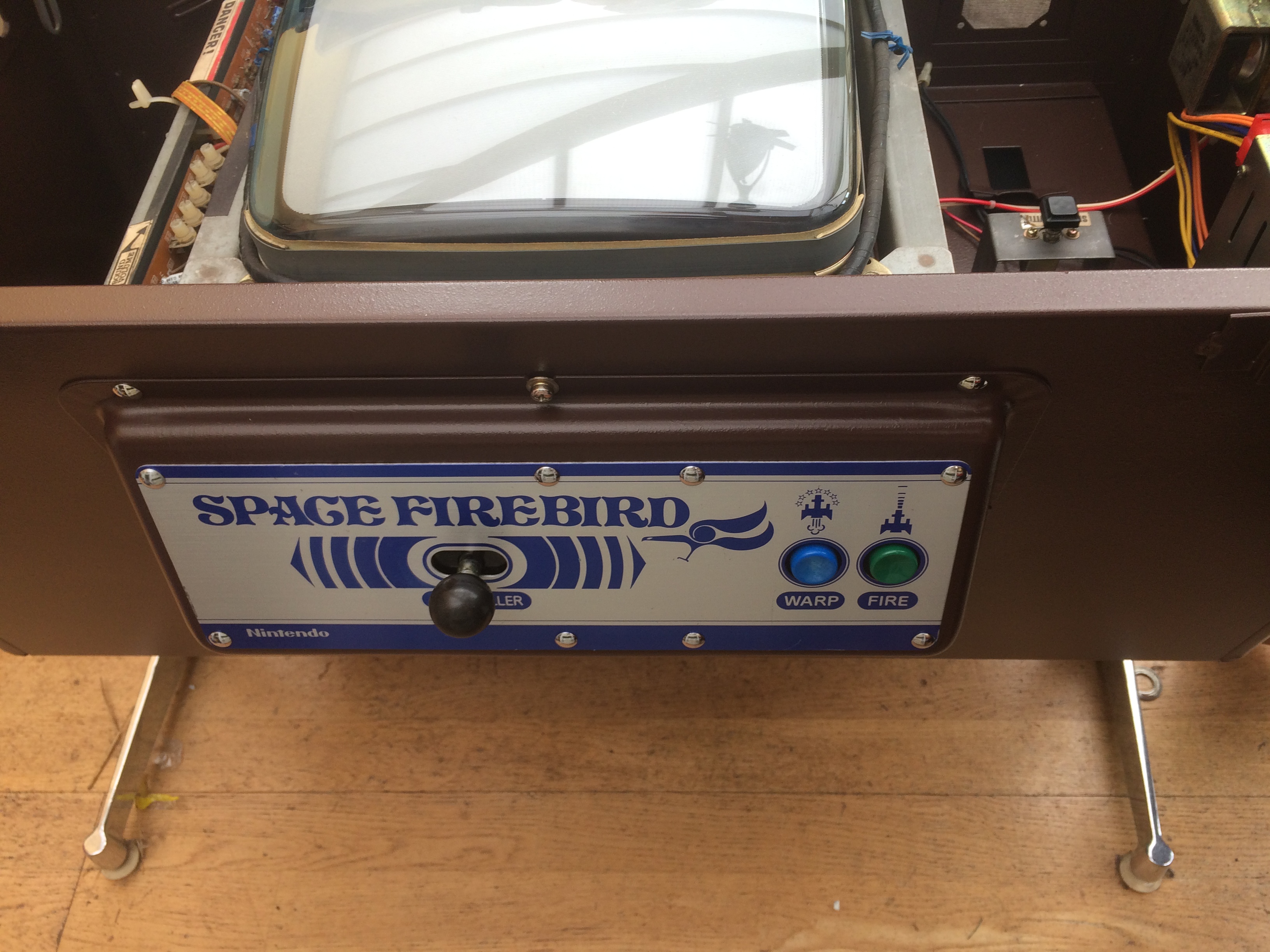

QUESTION!!
All the space firebird tables I’ve seen seem to only green and blue buttons!!
Is the fire button correct green or red??????
JC_R4CER
125CR
Spaceman25 said:
QUESTION!!
All the flyers (US, Japan and Europe) have the fire button as green. Good job as I'm struggling for reds!
Spaceman25
27CR
Allways!!! Red buttons have always been the ones you just can’t find!!!!
Thanks for info Johnathan as what I thought just marking sure

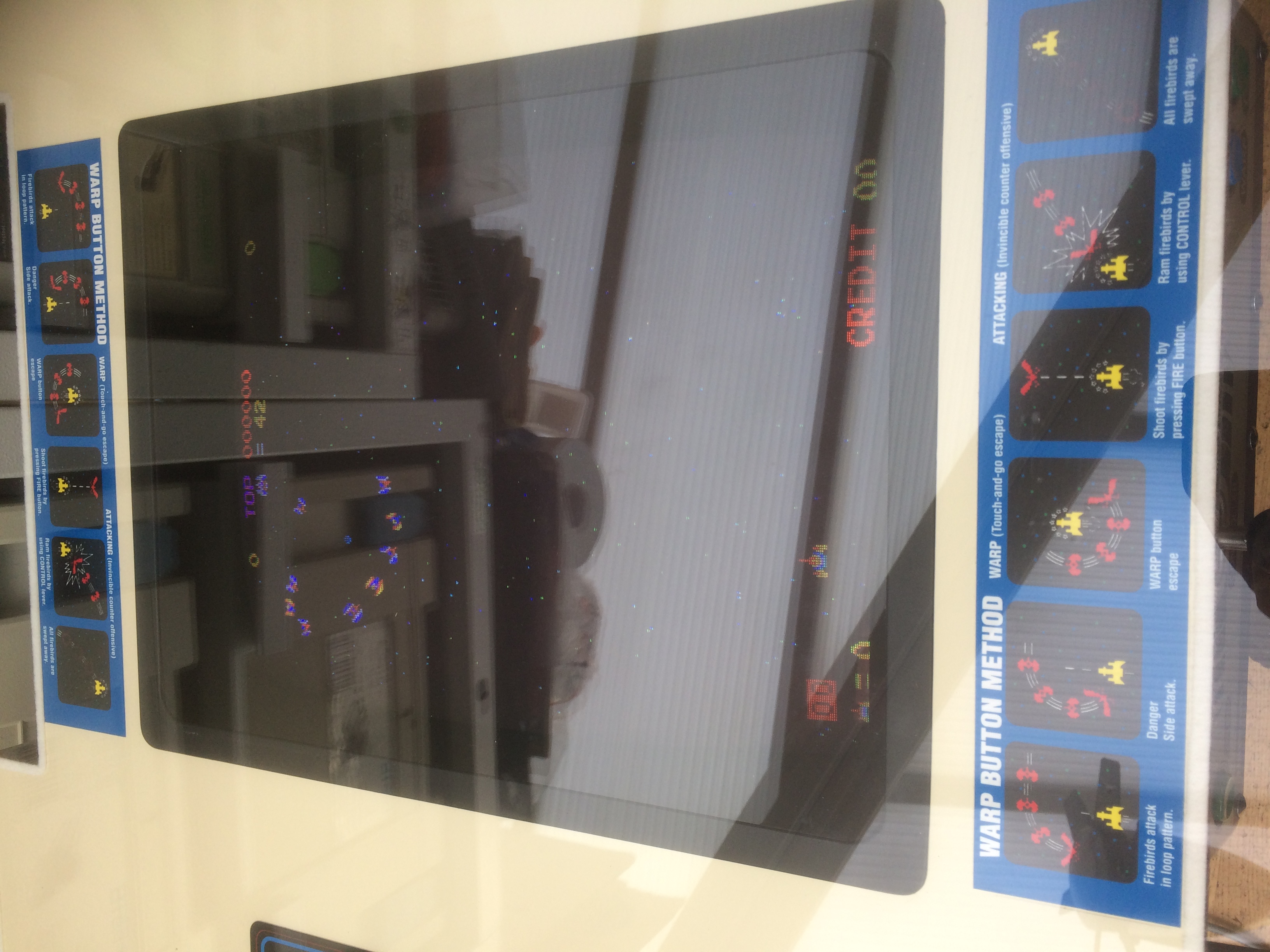

At long last it finished!! Sorry it’s been a long time since update!! Had a bit of a crummy year with everything going on but got there in the end!! Special thanks to olly for the artwork and Alex for the missing parts!!
That’s my very first restoration finished! Learned a lot on the way to achieve this now onto the rest !!
Watch this space!! Early Space fever b&w , space fever high splitter, and helifire all to come!!!!
