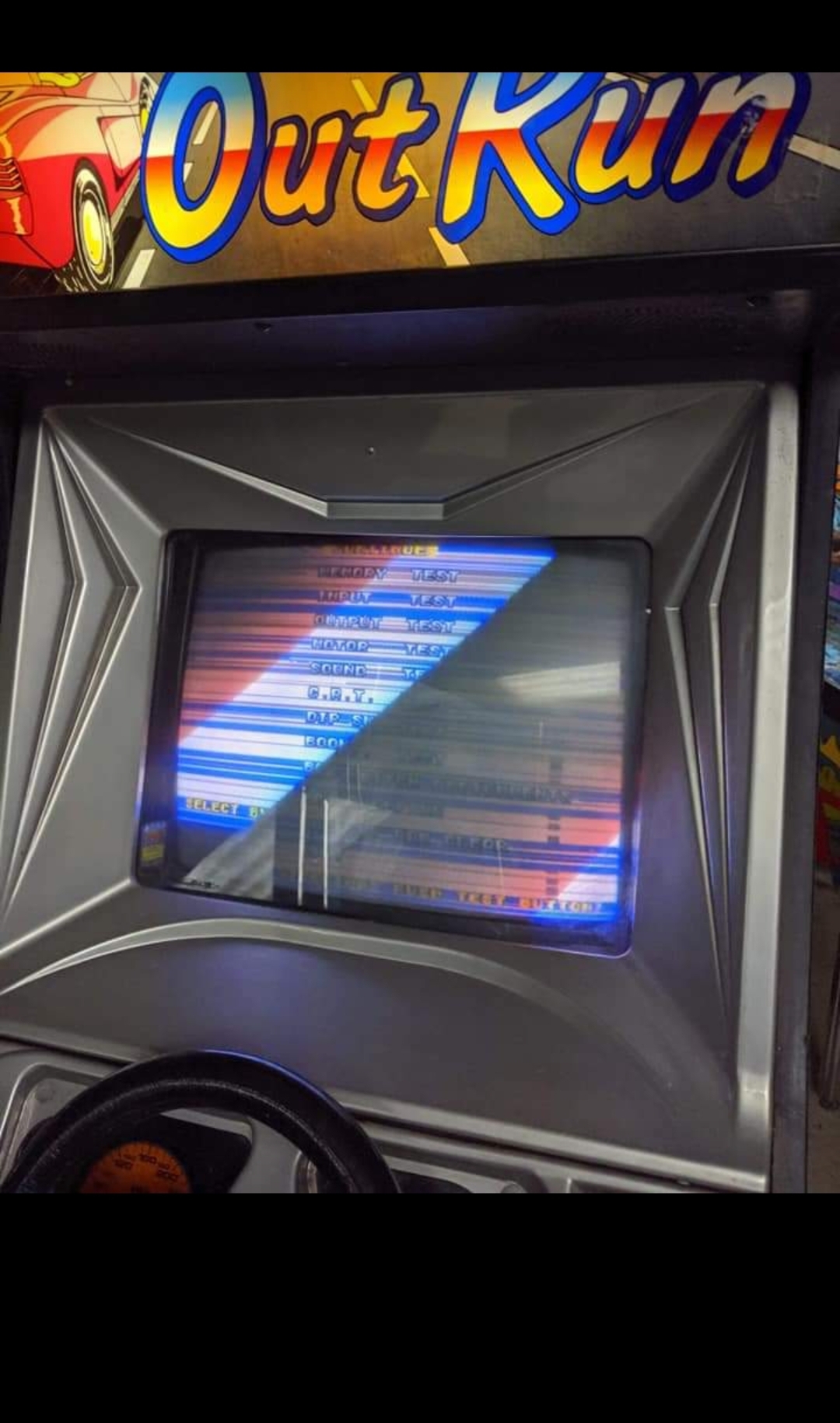

Ok I've been told that it plays normally some of the time, then sometimes plays with lines as per the photo and sometimes it wont play at all
Thanks for all the advice by the way.
What's the ball park figure I'd be looking at for a pcb repair, from worst case to best case scenario?
