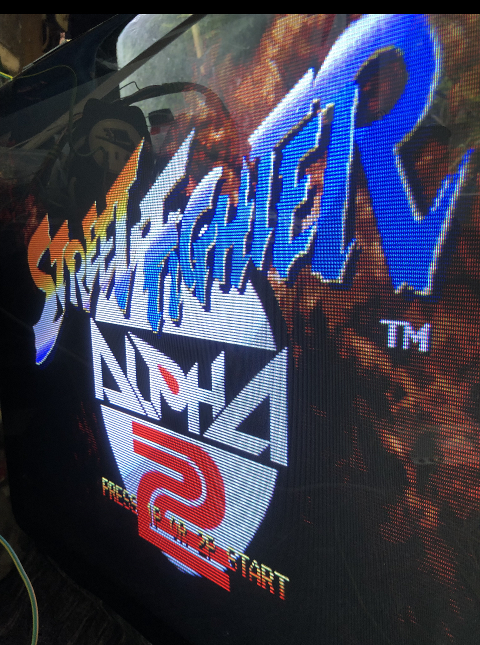

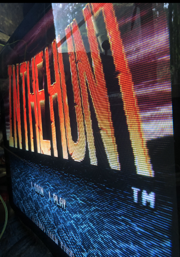

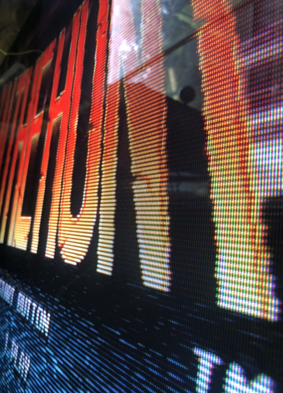

This next pic is the nos chassi
Tried soaking in as much as poss
And just can’t get it any better
Chassis must just be out of range ?Retroman8392022-05-26 10:45:12
