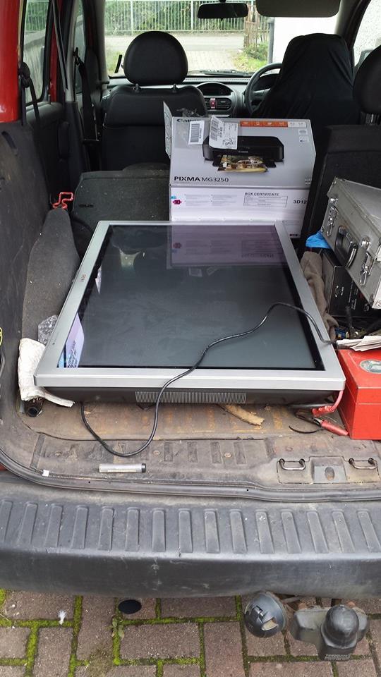

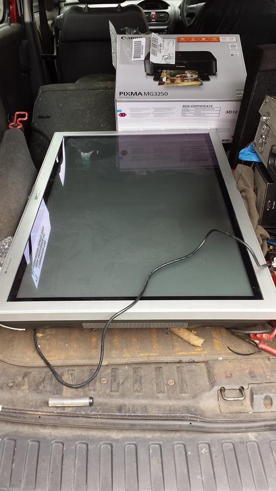

reet, just picked up a monitor for the playfield
it was a total fluke, i nipped round to a spar in the village next door to mine, grabbed a sandwich and a case of tennents and thought i might as well grab a quick pint, just the 1 though. the pub was empty then a guy i talk to now and again came in for a beer. i was telling him about the crap i have been getting from talktalk. so he says to me maybe you can help ??? so he told me about this big monitor that he was given by a neighbour. only problem is it won't run a tv picture but he can view his camera through it. so i asked if he wanted to sell it to me, no way he said, it cost nothing so you can have it for nothing
quick wheelspin out the carpark and 20 seconds later we are at his house
3 mintues and 17 seconds later, it's in the van, nice. i posted a picture of it on facebook if someone can snaffle it and post it here that would be great. so that's part 2 dealt with, at this rate it should be completed by about october 2016
just need to find a wee monitor and get mike to build the p.c.
total cost of build so far £30
karma is a weird thing, i missed out on the f-zero but got my telephone line sorted and a nice monitor for free
