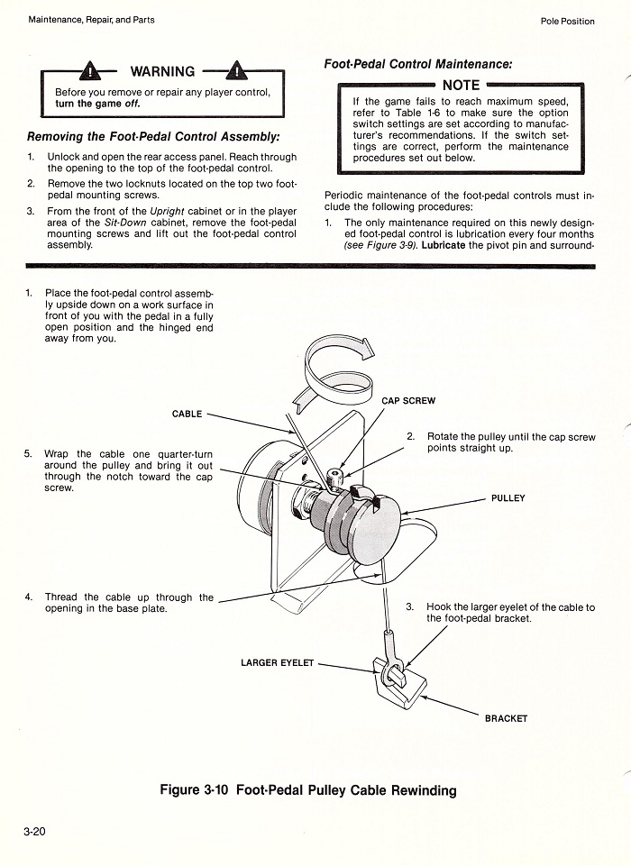

neil1637 said:
Good to know, for when I get round to putting mine back together again.
Just stick to the way it says to wind it in the manual.
I have heard people wind it however they thinks best and it never works correctly.
You need to have a bit of a play with it before bolting the pedal back in to get it bang on.
A little either way and it slightly accelerates all the time or never gets full throttle.
